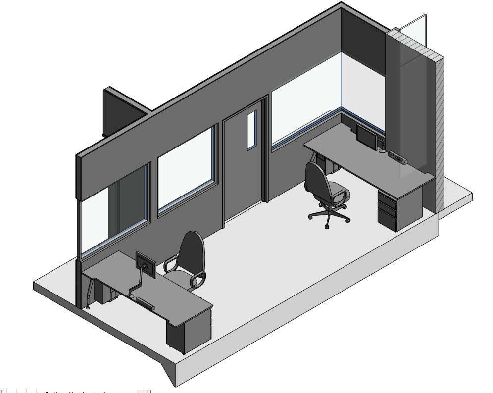

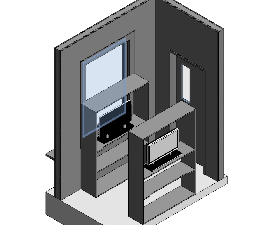

Using Revit 2013, an issue that has never happend before cropped up regarding glass. Nobody in my office has the faintest idea about it. Easiest way to explain is through the attached images. It appears that the glass is causing anything in front of it to become translucent. Could be the glass type used (Although I'm stumped as to why it has that functionality), but it could also be some form of global setting as glass I did not manually tinker with is also doing this.
Any ideas?

Is this happening on your computer only?

Just checked the transparency via printing a test page. It appears to be only on my screen, which would point to my computer specifically as the problem?

Graphic card issue... try to update the drivers

Yeah I'll get the IT guy to have a look at it (Access issues). I assumed it was something different as this is a brand new machine, guess he didn't update as much as intended!

It was totally drivers. Really should have thought of that - cheers guys!
