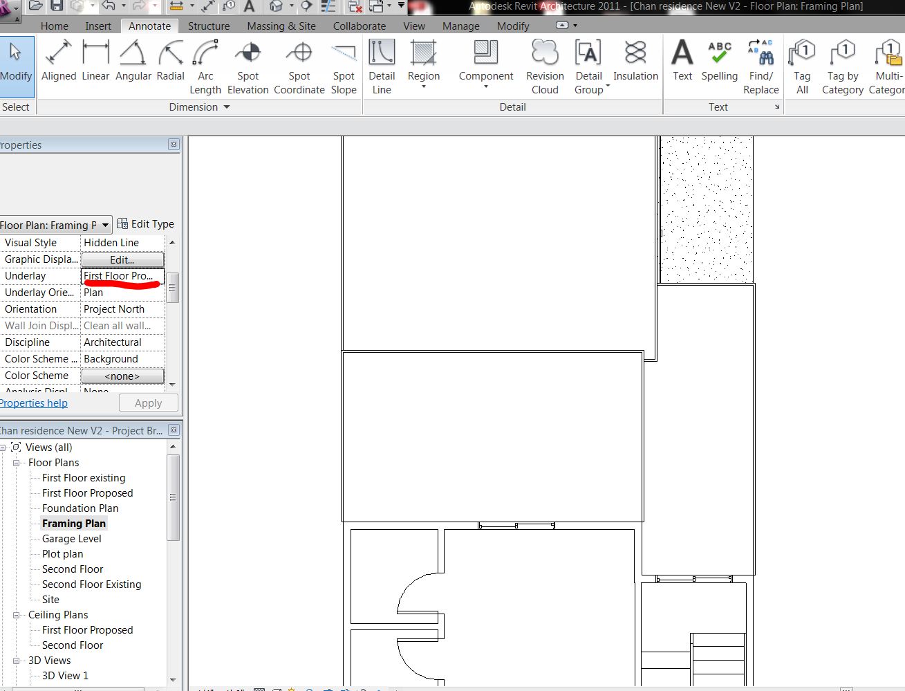

Hello All.
On this perticular plan the underlay option doesnt do anything. I am making a framing plan, so you can see roofs, and I want to ghost through the first floor plan...but it wont show..so strange as it works perfectly on others..does anyone have an idea on this? here is a screen shot.

Not sure if I fully understand but what if the change the Underlay Orientation to Reflected Celing Plan ?
Located right under the Underlay property.
