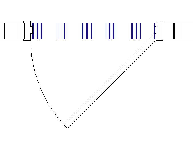

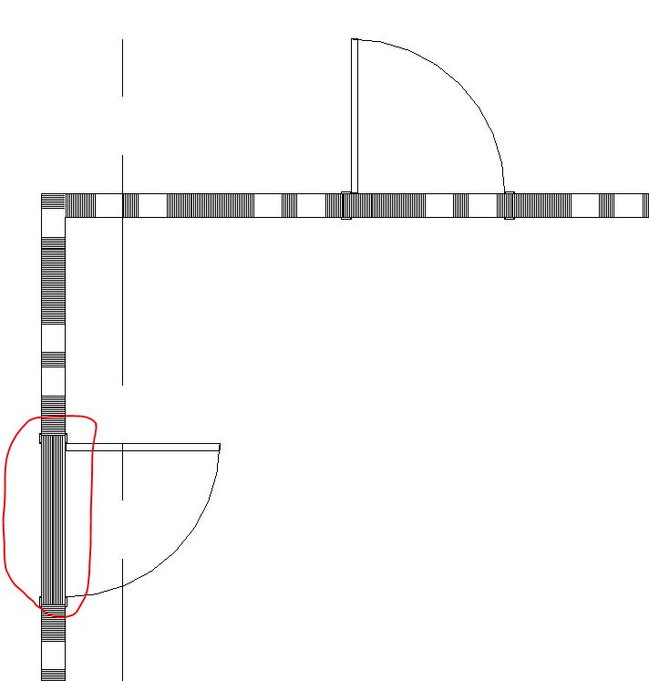

I have a door family that i have a generic annotation family (this family has the 1 hour fill pattern as used above)
but when I insert the door in a vertical wall the fill pattern stays like its in the horizontal postition
any ideas?

Use a Detail Component family to create your filled region instead of Generic Annotation.  You need to use a MODEL pattern type instead of a DRAFTING pattern type and you cannot create a model pattern type using the generic annotation family.

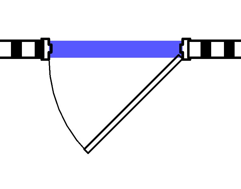

Teafoe, that worked
but now i have another issue that someone can shed light to, lol
I used a detail component that that has my desired model fill pattern inserted into my door family. In the door family I have that fill pattern with a yes/no parameter and visibility to show only on course mode.
wehn inseted into project, course mode show my fill pattern appears on screen shaded
but if I change to thin lines, it shows correctly

there is 2 images attached above

Does it appear correct in the family?  Can you attach the door family so I can take a look at it?

It has to do with the scale of your fill pattern in your Detail Family.  It only shows at 1/16" and smaller, any bigger and it becomes one solid fill.

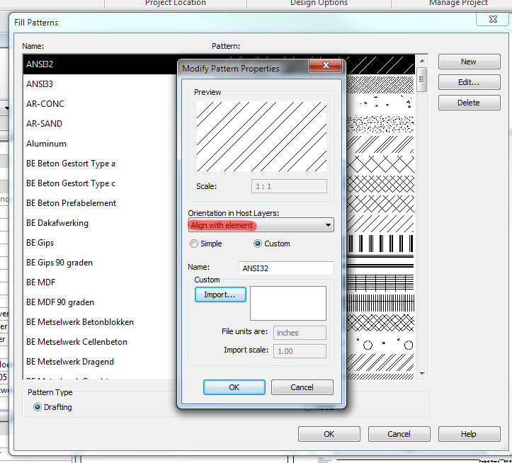

Mon, Jan 28, 2013 at 8:30:02 AM | Rotating Fill Patterns
#9
Dafpfy
Joined: Sat, Dec 29, 2007
286 Posts
3.5 Stars: 11 Votes
Try this setting..

Mon, Jan 28, 2013 at 8:34:03 AM | Rotating Fill Patterns
#10
teafoe5
teafoe5 Avatar
Joined: Fri, Nov 12, 2010
1749 Posts
4 Stars: 47 Votes
It is already set to the align with element setting. The problem now is the scale of the fill pattern.
