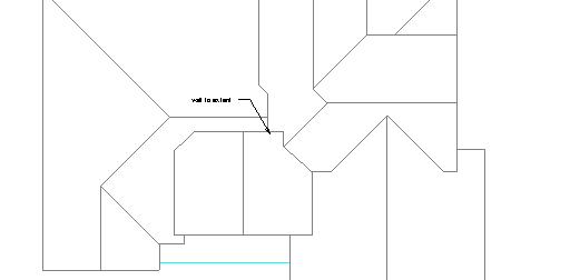

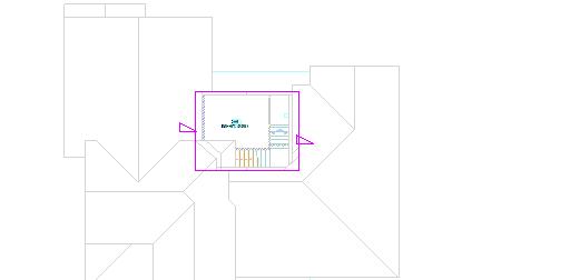

Hello,
I've only been workting with Revit roofs for a short time.  I am unable to close an upper roof with a lower roof.  See attached file.
Can somebody point me in the right direction how to fix this roof problem?
Also, let me know if this is not the best place to post this question.
Thanks for any help on this matter.
Dave

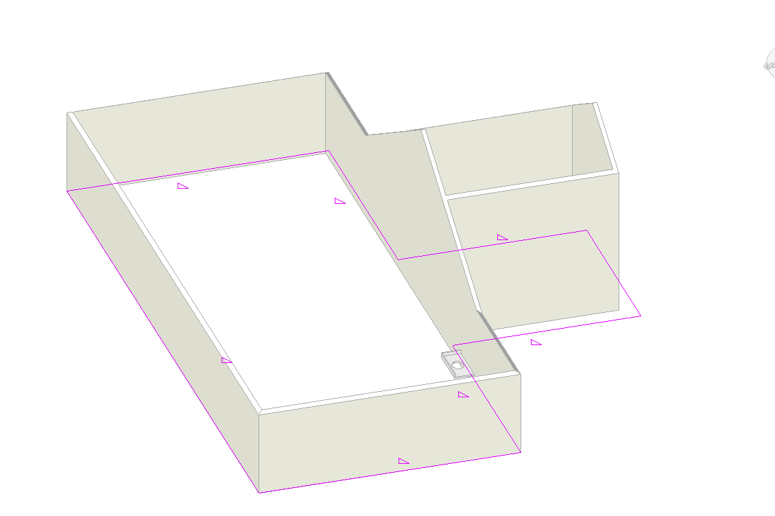

I am not sure if this is what you after. Can't tell where your arrow point to on model. (plans and elev. easlier to read) try edit the upper roof to match the lower roof.

Mon, Jan 21, 2013 at 2:37:08 PM | Roof Problem
dave1986
Joined: Mon, Mar 19, 2012
4 Posts

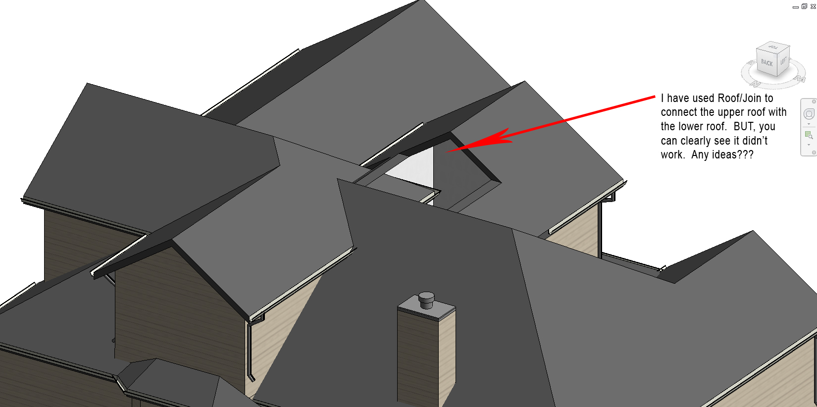

Sorry about that.  Hopefully this attached jpeg image will make thinks more clear.
Thanks for any help.
Dave

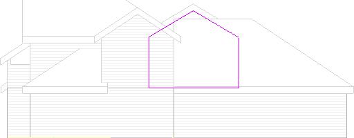

I was able to join a hip roof to a gable roof by doing the following:
1.- choose roof by extrusion
2.- In skecth mode I skecthed the shape  and hieght of my gable roof( it is important not to have a closed loop when using the extrusion tool).  For the roof by footprint tool you must close the loop. Hopefully this step should solve your problem.
3.- Now that I created a hip roof using the "roof by footprint" tool and created a gable roof using the "roof by extrusion tool", I can now join the hip roof to the gable roof.
4.- I chose the the join the roof command, clicked on the edge of the hip roof and clicked on the edge of the gable roof.  Now both roofs are now joined. Both roofs are joined. However, I have not figured out why when I click on one roof, why both roof don't highlight as 1 whole roof.
If someone can explain to me step 4 further, I would appreciated it.

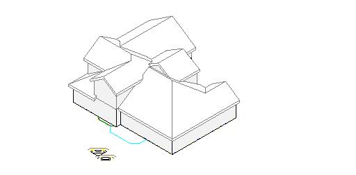

hopefully this will help you solve this issue. your roof is not on the stairs wall. You also need to extent the stairs wall and edit profile the wall to seal the gap, attached the wall to the roof will not fully seal it.
Mon, Jan 21, 2013 at 10:05:34 PM | Roof Problem
#9
TT65
Joined: Tue, Jun 1, 2010
6 Posts
oh, btw it going to be beautiful design. however, you might like to look into the leaking issue near the stair area. Extending the gable to the hip of the lower roof. create a storage in this pocket space. you will find out as you work on the design. all the best.

I joined a hip roof to a gable roof. But now one side of the gable roof has an trangular opening that I would like to cover with same material as the hip roof. Does anyone know how to do this?

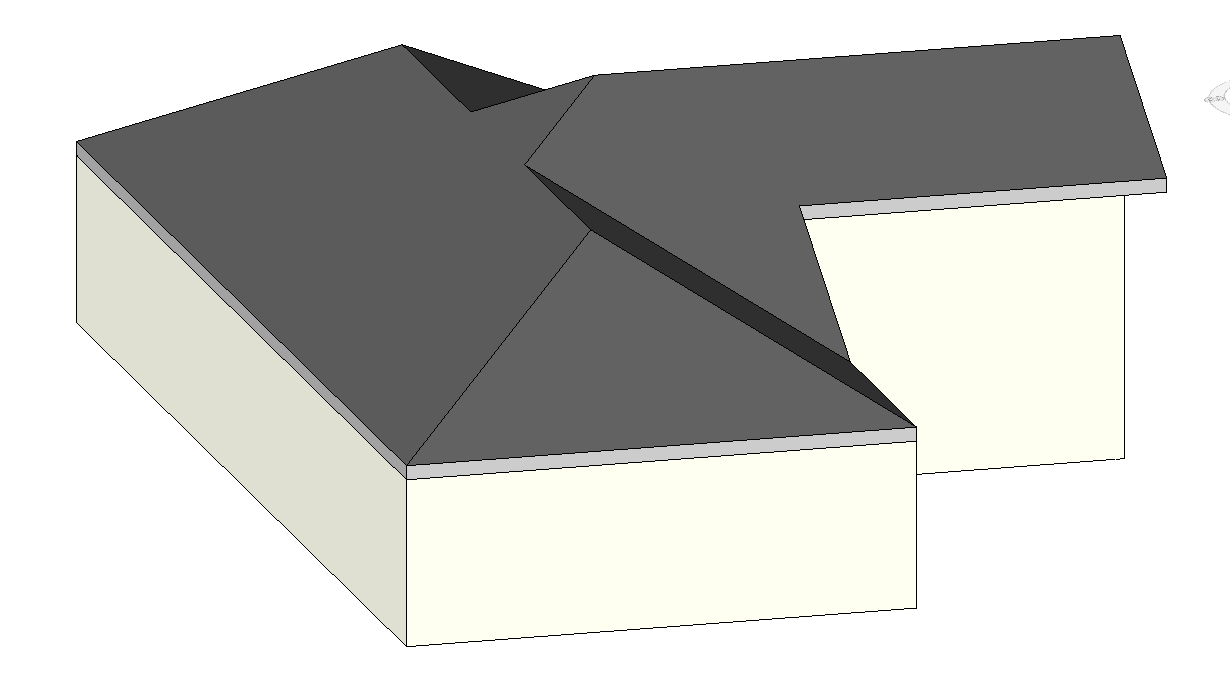

Is this what you are trying to accomplish? (see attached) You need to create the 2 roofs as 1 for it do accomplish what you are attempting.

YES, TeaFoe5 that is exactly what I'm trying to accomplish. How do you make this happen, when the lower hip roof is on the first floor and the upper roof is on the second???
It looks like you have one boundary???  How does this work?
