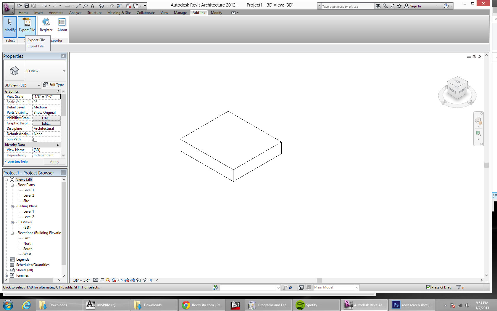

I downloaded the collada exporter (not thru Lumion because it didnt allow me) but everytime i try to import it into Lumion, it says "lumion has stopped working".  The file is a .DAE file that it saves it to.  Any thoughts?
Tue, Jan 8, 2013 at 3:39:59 AM | Exporting revit to use with Lumion
Joined: Tue, May 22, 2007
5921 Posts
4 Stars: 205 Votes
You have to use the "Collada Exporter" from "Lumion"
