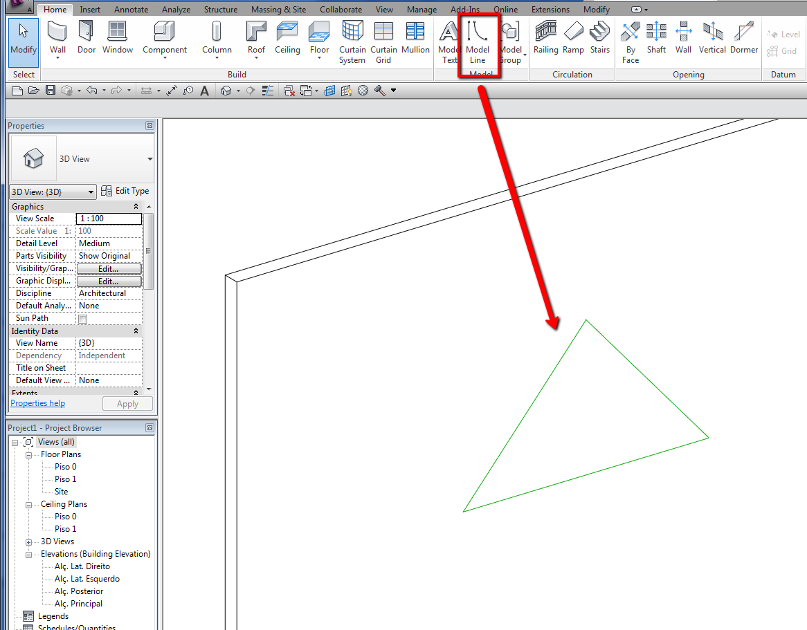

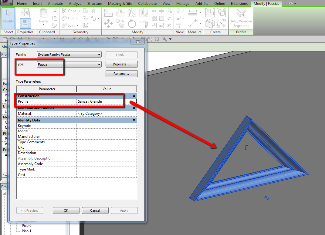

Simple... use a "Roof Fascia", just select the 3 edges, done.
If you need create three "Model lines" then select those lines

Aha! I tried all manner of gymnastics but always assumed that only a roof itself could host a fascia. Brilliant. Thanks, Typhoon. Your posts are always appreciated.
