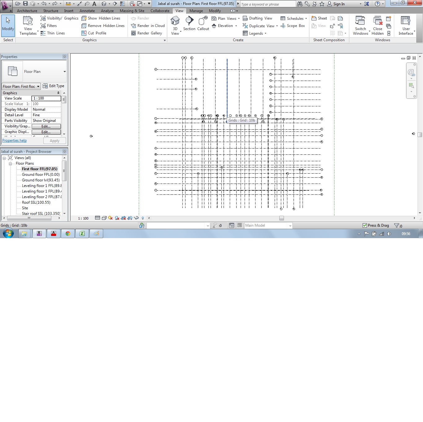

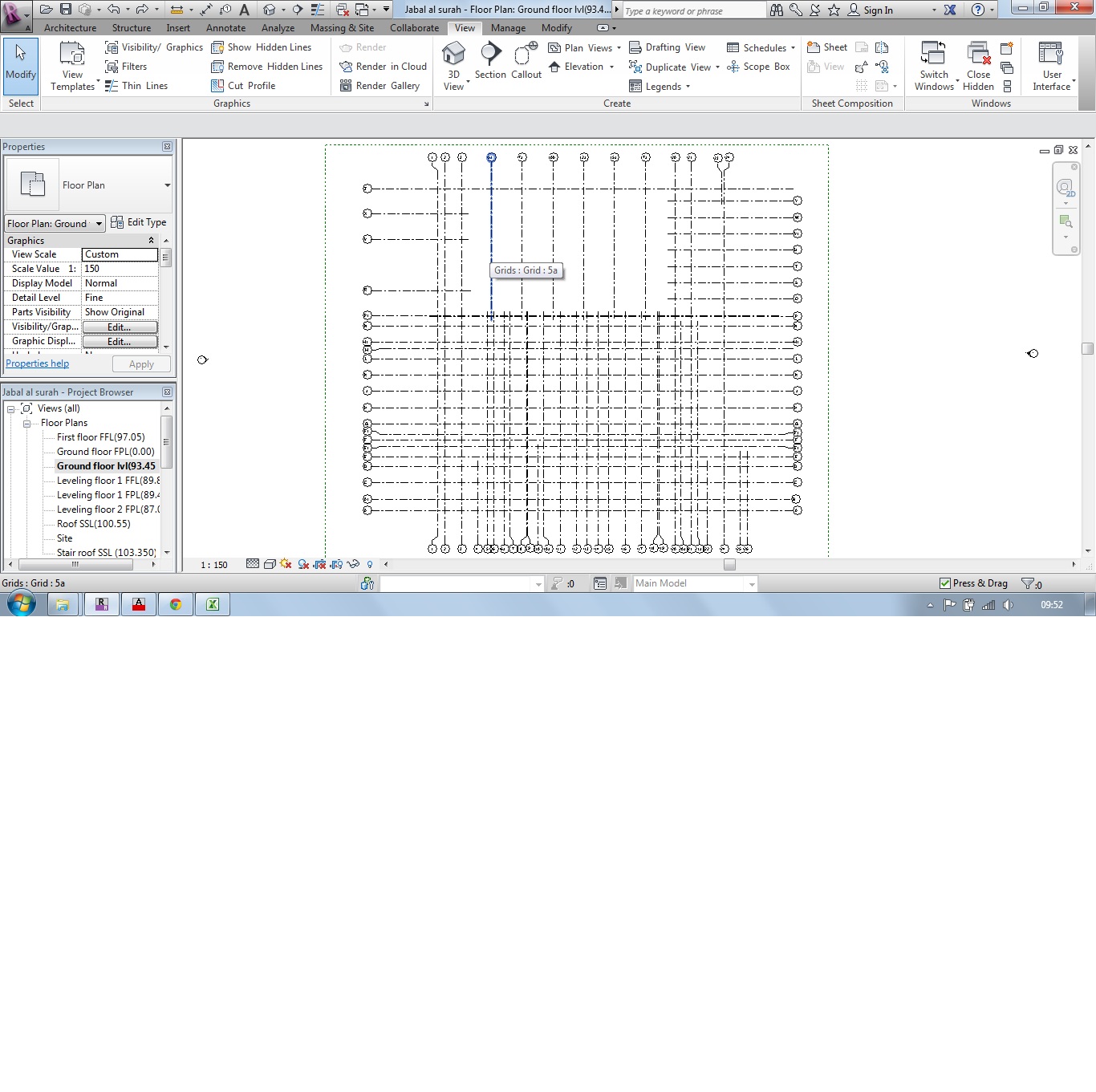

Hello all,
I done some grids in a level and aligned it (like draging head, changing head direction). Then I have created some more levels. And I gone to elevation and draged(extended) the grids to all levels. So I can see the grids in all level plans. But the problem is, alignment (changes) made in intial levels are not showing in other levels. I hope there should be an option to make grids in every level looks same. Or need to change each by my own??? (grids are in 3D extent)
Thank u.

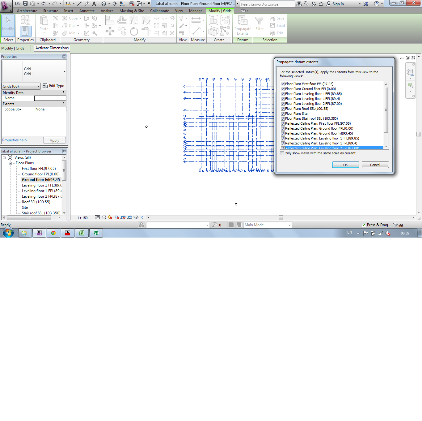

Things like elbows in grids (as shown in the OP's attachment) do not update automatically in other views, not even if the settings of the grids are for 3d, nor with scope boxes.

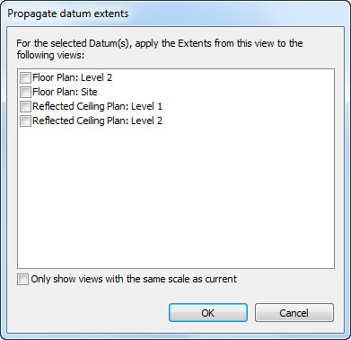

To transfer the same appearance to other views, select all your grids > Propagate Extents > select the views where you want to "copy" the same appearance.

I didn't know Scope box becoz I'm new to revit. I am trying to know now. But Propagate datum extends works perfectly.
Thank u very much alfmidedina and WWHub.
