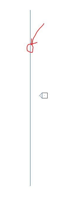

Hello everybody,
I have problems with the elevations it shows like a section.
I've tried to fit that moving the "elevation marker" and changing the "far clip plane" but it doesn't work. The elevation views still seem to be inside the building.
How can I solve it?

When you click on the tip of your elevation there should be a blue line.  This line shows where the elevation is being shown from, if this line is inside your building then it will cut like a section.  Move it outside your building.
