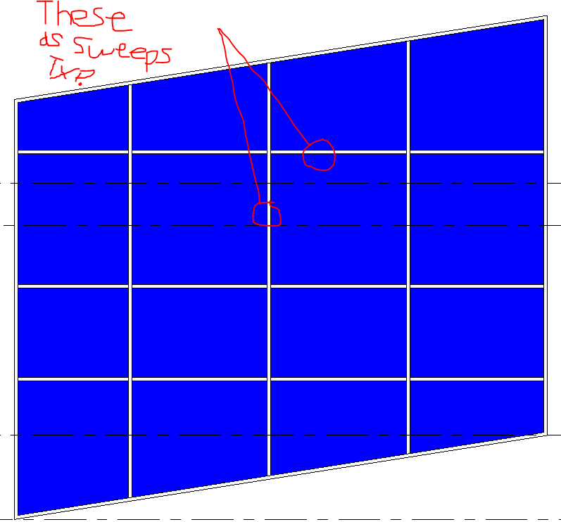

Just draw your curtain wall straight then click on it and edit profile and change the slopes of the top and bottom to whatever you want.  Then you can create your mullion profile and add sweeps for the mullions.  Unless I am missing something.  A picture of what you are trying to accomplish always helps

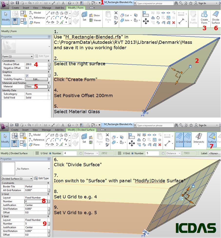

The 9 steps in the attached figure shows that we can create glass material and grid on a inclined
surface of a SweptBlend. But it is done on a family template file "Metric Mass.rft",
or "M_Rectangle-Blended.rfa"
A.
I prefer Curtain wall "Storefront" type with "3D" mullions, not just 2D line grid.
But it can only be done in project.rvt.
And I am not sure how to make a curtain wall inclining by click.
B.
The best is we know how to program it the API (Application Programming Interface),
so it can be done for all surfaces, at all levels, at once.
But it is good to know how to click first.
I am very interest to read your experience :o)
