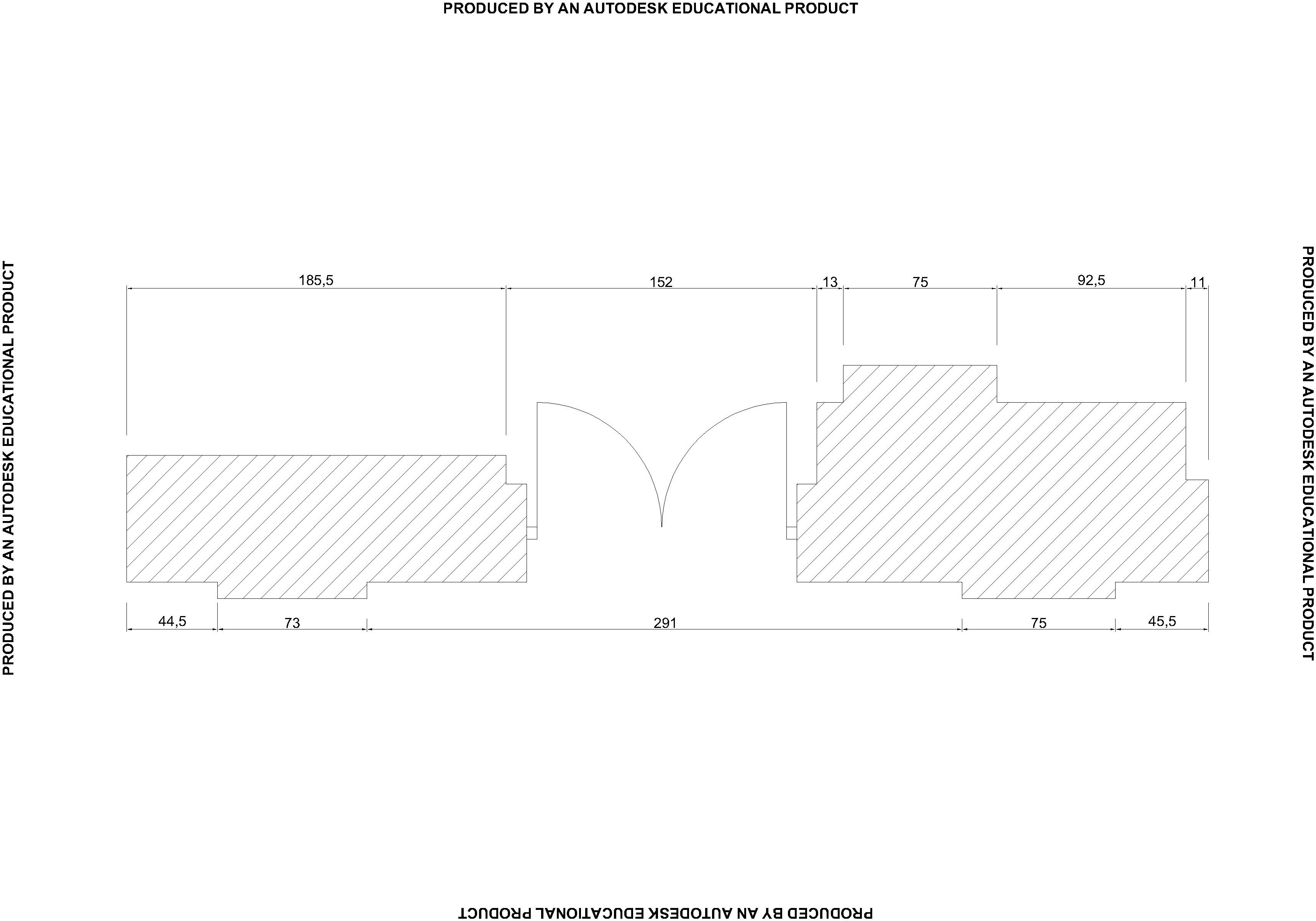

How to create a wall that has many thickness changes? I need to create a wall like one in attachment. Any clues how to start?
btw I am using revit architecture 2013

I have tried to make sweeps but I dont know how to edit the profile of sweep.. Also if I make the vertical one the texture is oriented vertically too. Is there an option to rotate the revit base texture?
On the other hand revit didnt allow me to make a void from without exisiting mass.
the architectual columns worked! Thanks for help.
I was just hoping there is a way to crate just a wall rather than play with different elements.

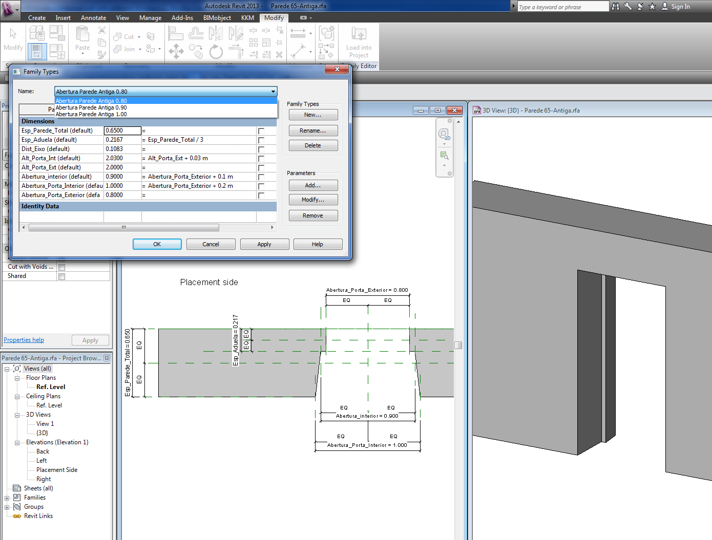

Few years ago I created a family for that, we use alot this kind of walls in Portugal.
Create a family.
Wall Thickness in Type Parameter
