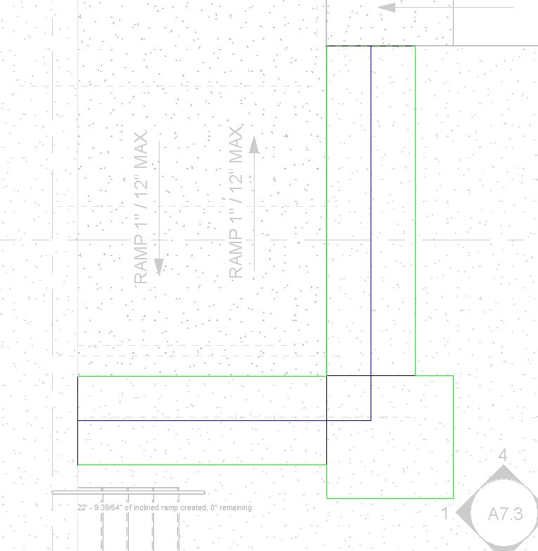

Tried searching for an answer to this, but I am coming up empty.

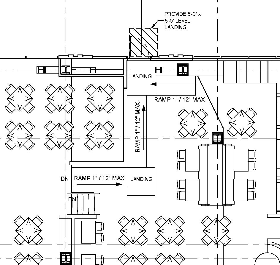

I am trying to run a 23' long, 3'-6" wide ramp in an "L" configuration with 5'-0"x5'-0" landing to meet accessibility requirements.  However, after I've laid out the run and try to edit the landing I receive the "Stairs require no more than two boundaries (chains of one or more Boundary Lines)." error.  I've checked and double checked for short lines, doubled lines, etc... no avail, everything appears right.  I've drawn the landing with chain option on as well...
I know I could split into 2 ramps with a floor, but this ramp is so variable I'd rather not have continually be adjusting the height of the floor.
Attached are two images, one showing how I want the ramp to show and the other a screen shot of my sketch(the one with color)...
Thanks.

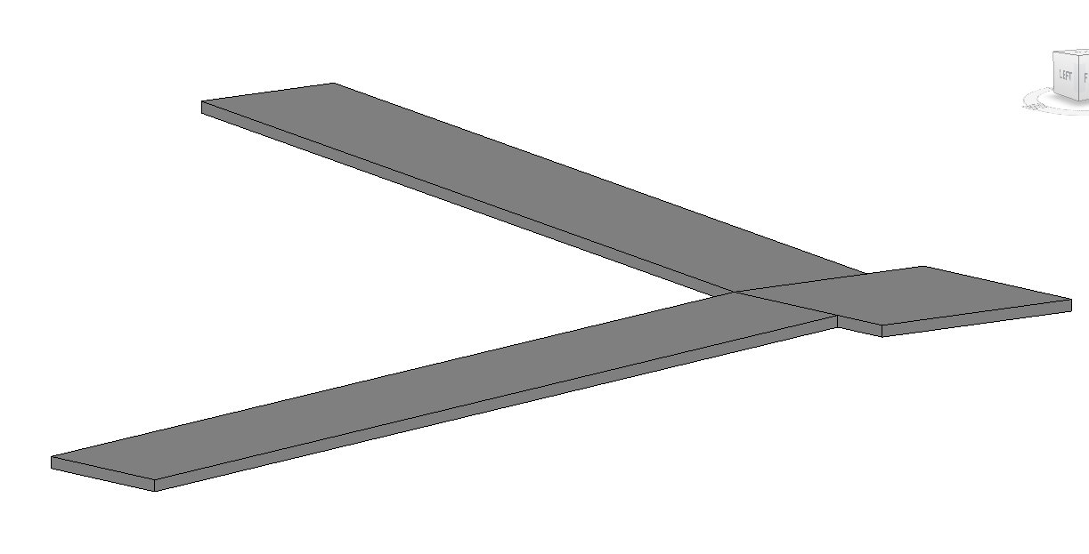

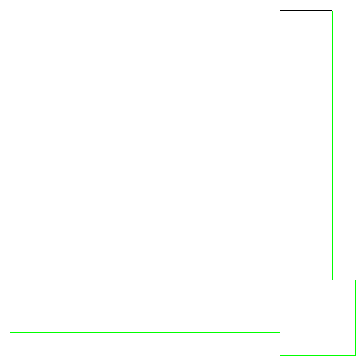

You may want to start over and check your process. I created a ramp like you are asking by using boundry lines and 4 riser lines.  See attached.

After 3 tries, I got it to work...  By just using 2 lines and offseting, splitting and trimming them.  User error then...
