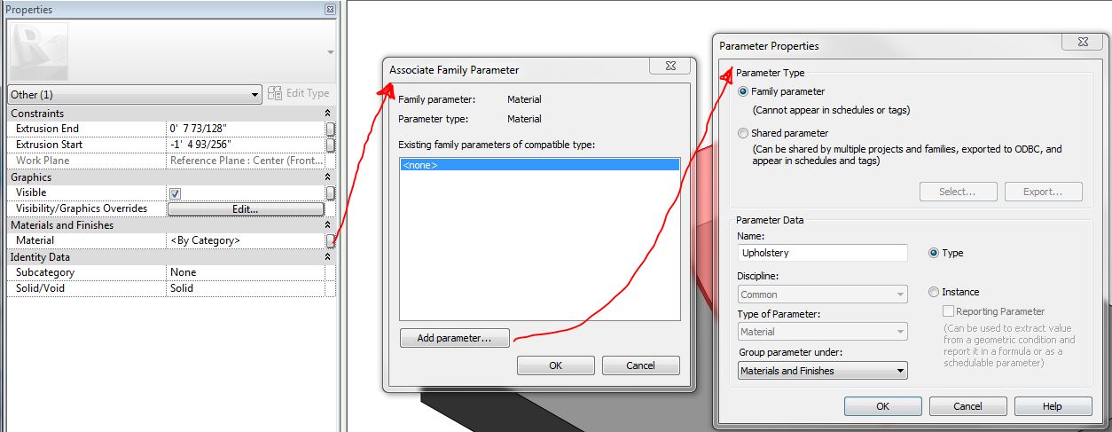

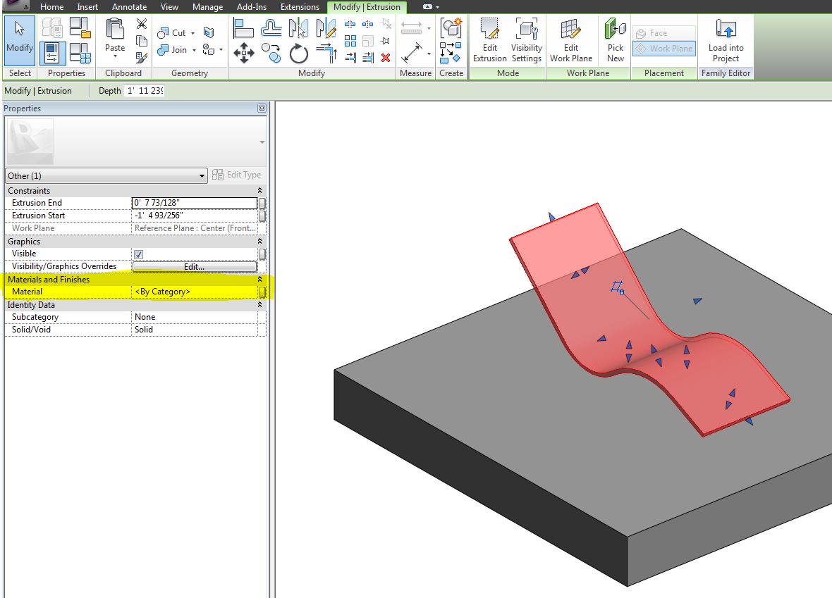

This is a message to a YouTube users question on how to do the above. (you can see the convo here-http://www.youtube.com/user/theRevitCollection) When we have time to do a video we will on this topic!
Anyway, I am not sure how you are not able to place a material and are saying you don't have that option. So make sure you are going through the steps in this image and it should work!

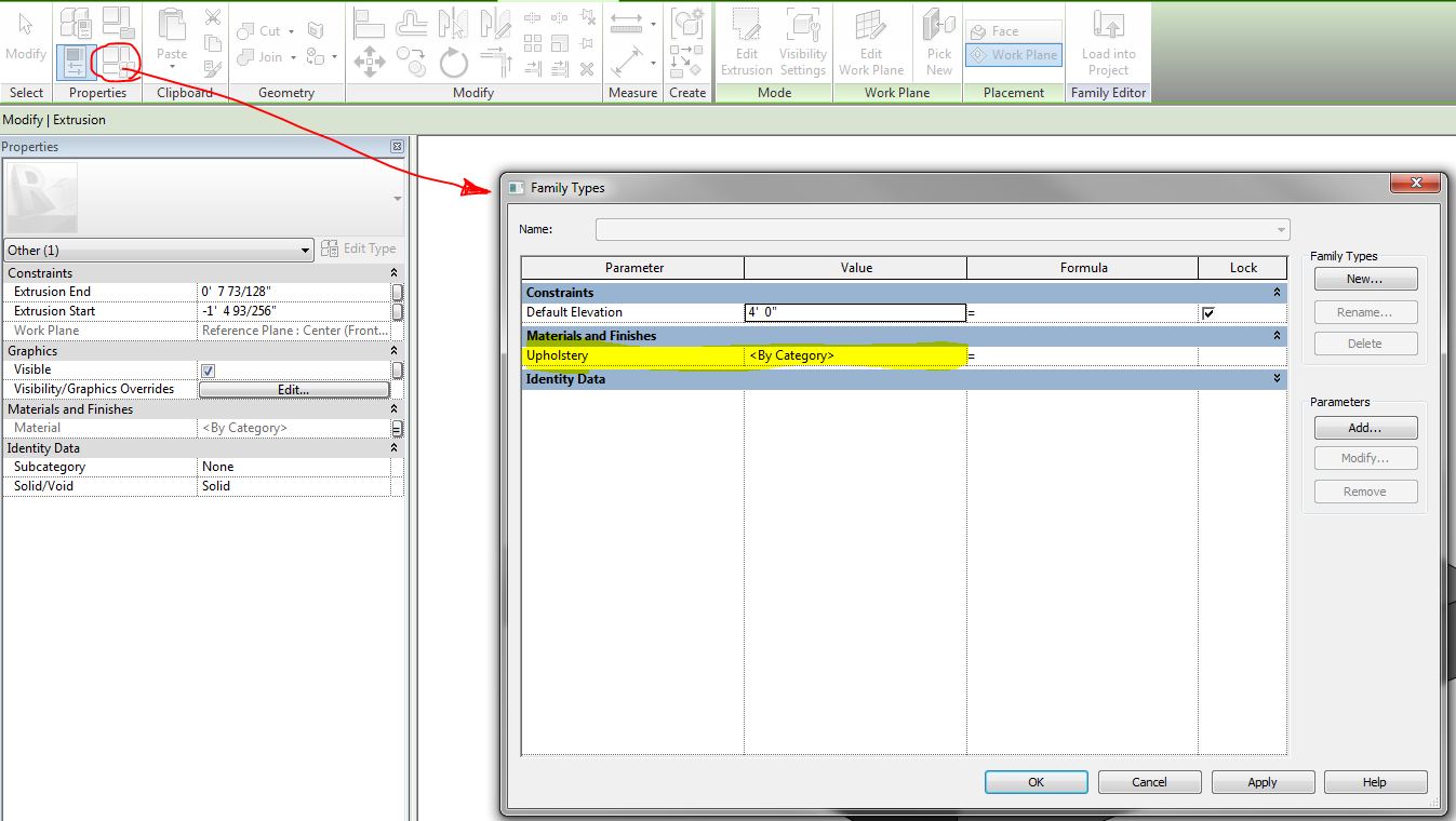

To simply add a material to any object, select the extrusion (or blend, sweep, etc.) and click the 3 dots next to the material category. That will allow you to apply any material within your family which will carry into your project
To create a material parameter, click the little gray box next to the material category. This will allow you to name a material parameter and choose whether it is an instance or type. You will also see when you check the properties of your family, that parameter is now in there
Doing that means when you bring the family into your project you will be able to see the material parameters either in your instance or type properties of the family (whichever you chose when assigning it). That of course, allows you to change the materials within your project rather than having to open the family.
Hopefully that clarifies things!

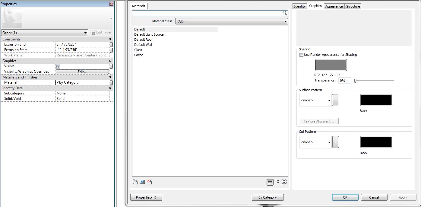

Hi,
Sorry for the late reply. Its Dai Lo from youtube.
Thanks for the detailed explanation.

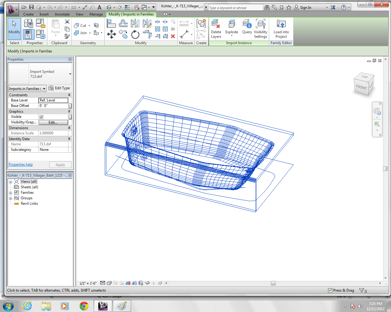

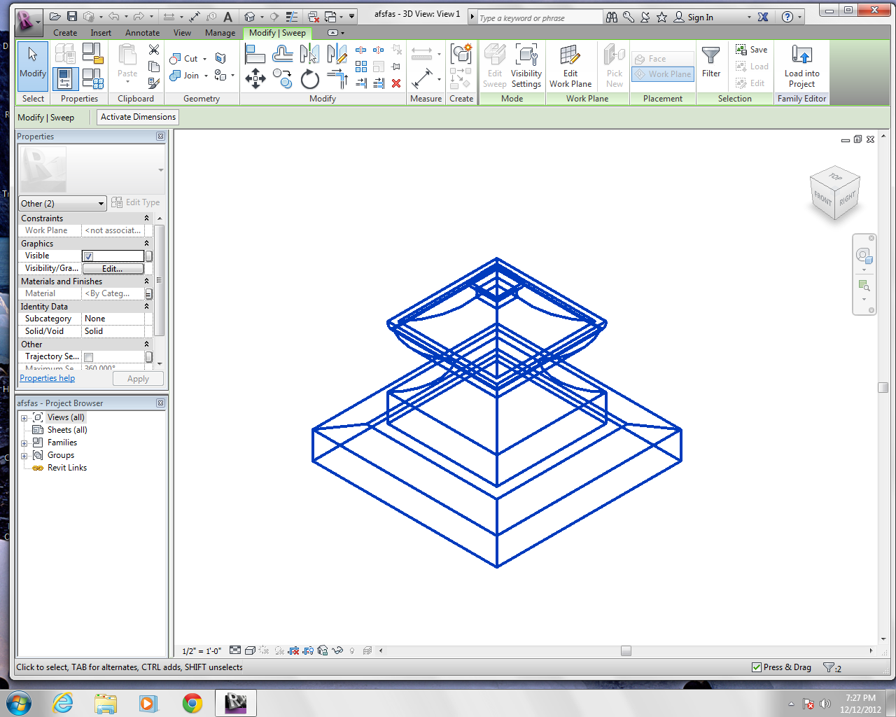

I'm really sorry but I still can't find the material category (Shown in the pic with the tub).
And, btw do you know how I can change the dimensions in the family shown in the 2nd attached pic or
is there a way to scale it (make it bigger).
Thanks, and once again sorry for being a noob/newbie at revit.
Wed, Dec 12, 2012 at 9:49:33 PM | Placing materials on objects in a family
revitape
revitape Avatar
Joined: Tue, Nov 13, 2007
111 Posts
4.5 Stars: 9 Votes
ahhhhhhhhhhhhhhh now I see what the problem is. That "extrusion" you are trying to put materials on is actually a CAD file someone mistakingly tried to pawn off as a revit family. You can see this because in the properties it has the file name, "713.dxf".
I personally hate when people do that but it is neither here nor there. I would try to find another bathtub if you can... or if you are feeling really brave try and model using Revit and let the CAD file be your reference. If not, I am sure there are plenty of others out there you can download and bring to your project.
As for your other problem... go to the type properties of that object. If there is a dimension parameter and it is modeled correctly, then you can change the dimensions and it ideally should change. BUT, since that is a sweep, I doubt it was modeled correctly to dimension parameters. You could edit the sweep and change the profile if that is what you actually want bigger.
Lot of stuff to learn and I am sure a lot of what I said is still difficult to grasp! But keep asking questions, we were all newbies at one point!

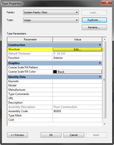

Fri, Dec 14, 2012 at 2:58:06 AM | Placing materials on objects in a family
Joined: Tue, May 22, 2007
5921 Posts
4 Stars: 205 Votes

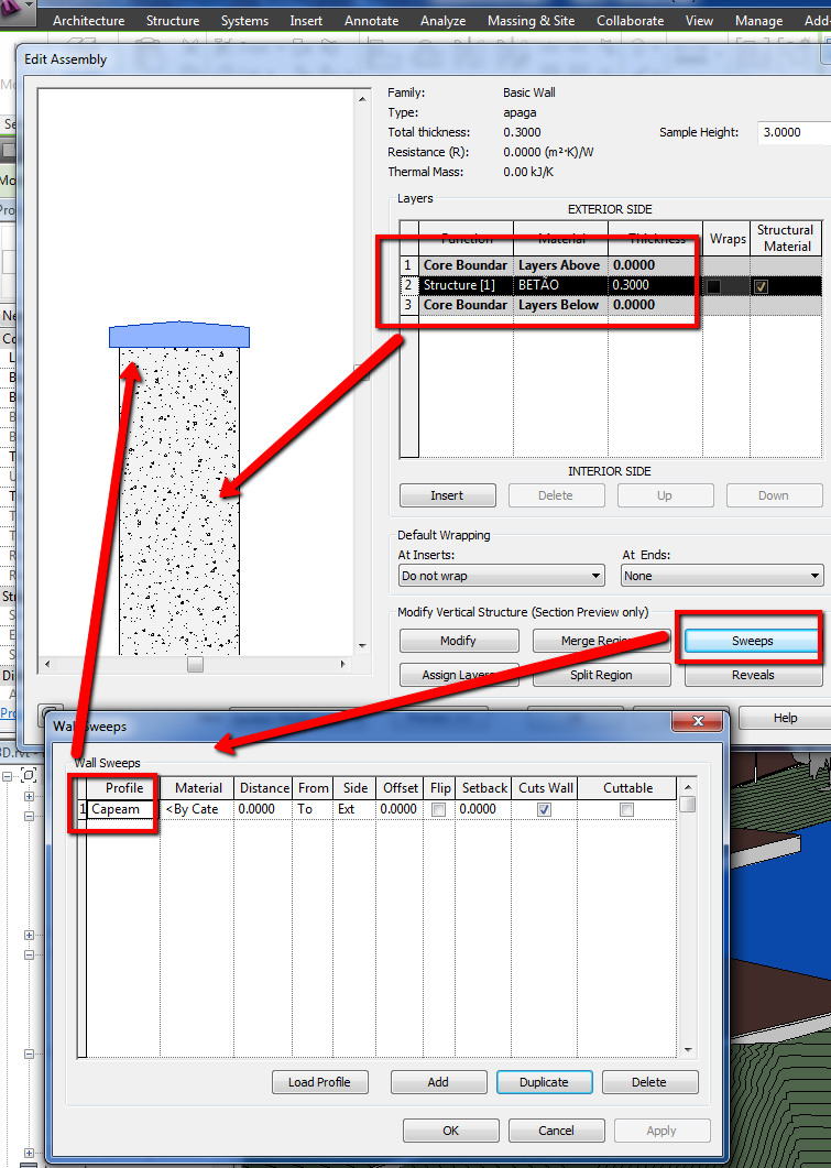

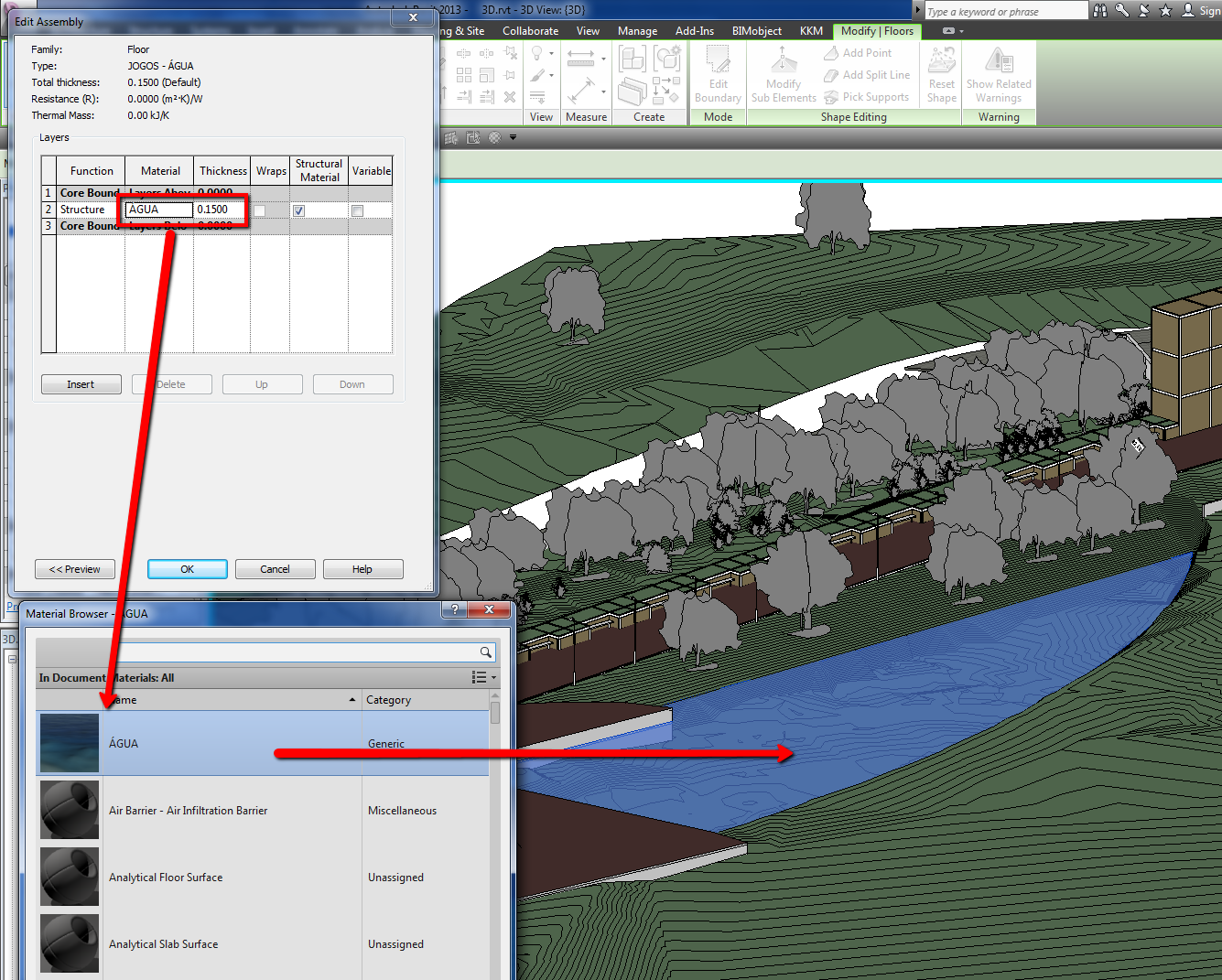

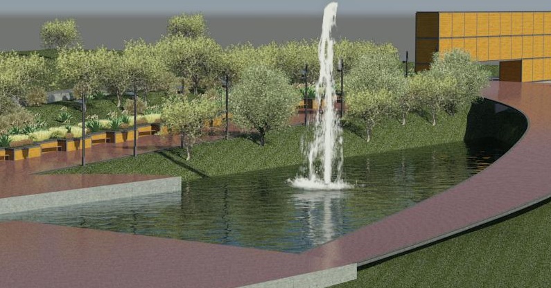

WATER = Create a floor and change the material. (Image 1)
WALL = Create a Wall and assign a "Sweep" (Image 2)

the boat is simple... just put it on the plane of the water. in theory water is always "flat" or level right? so what you want to look real is how it looks when it reaches the shore or meets the land.
you could do what typhoon suggested and it's similar to what i do. the important thing is to make sure your "floor" is deep enough to go past the topo surface and also wide enough to hit where it meets the ground. that will give you a more realistic look.
personally, i just create an in place family and adjust the depths as needed. but if you draw a floor like typhoon just make sure the thickness is deeper than the bottom of your water to the top of the water surface. it's all about how you use it in the end also, for rendering the depth isn't as important but for a shaded view (like my image) it would make a difference.

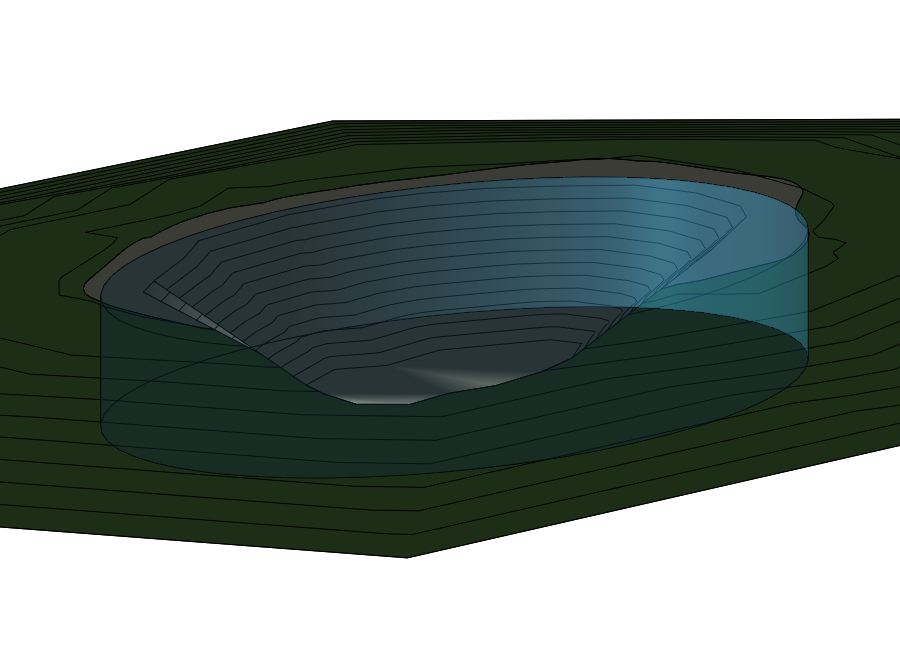

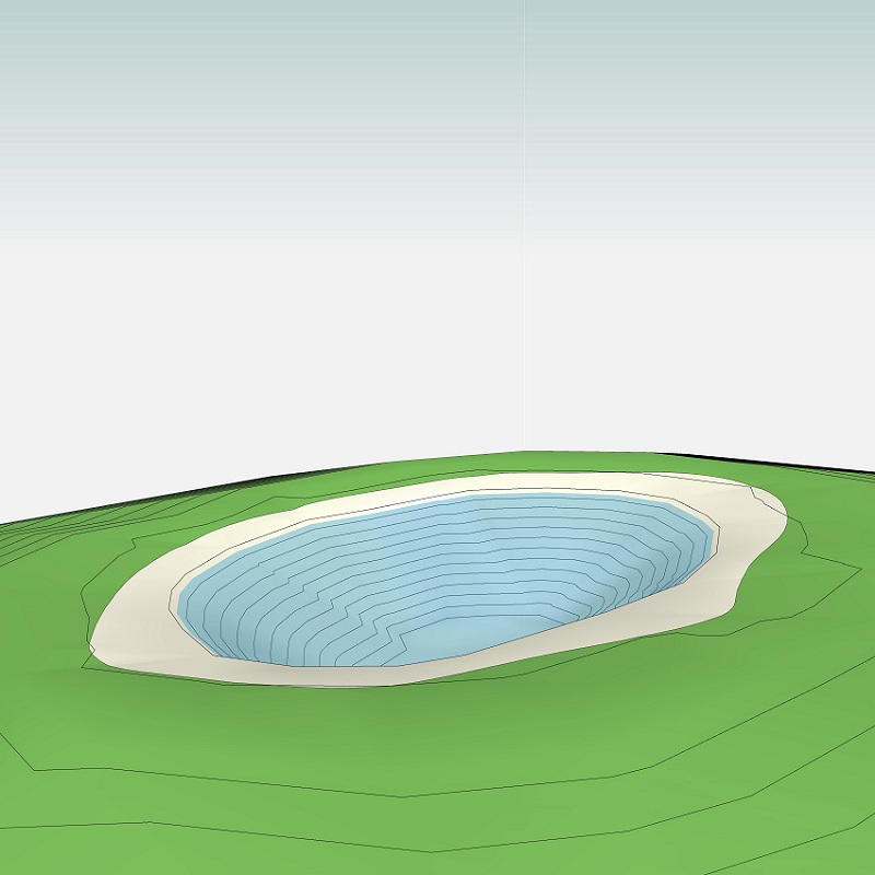

Fri, Dec 14, 2012 at 12:10:12 PM | Placing materials on objects in a family
#9
revitape
revitape Avatar
111 Posts
4.5 Stars: 9 Votes
Sorry, I forgot the other image which shows what it looks like beneath the topo surface

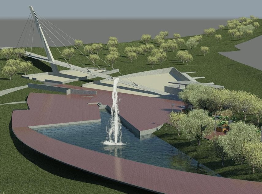

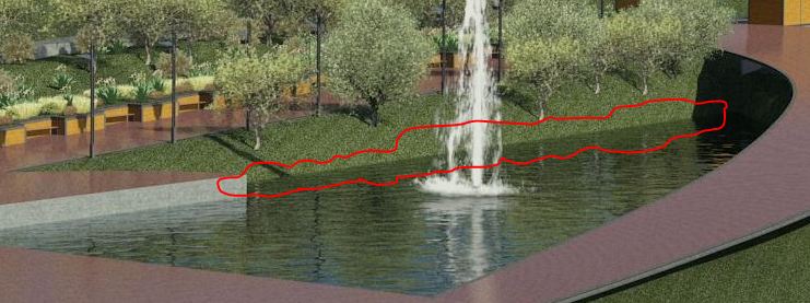

Fri, Dec 14, 2012 at 1:50:14 PM | Placing materials on objects in a family
#10
5921 Posts
4 Stars: 205 Votes
This is the effect I'm talking about....
Fri, Dec 14, 2012 at 2:01:55 PM | Placing materials on objects in a family
#11
revitape
revitape Avatar
111 Posts
4.5 Stars: 9 Votes
Yeah that looks great except the reason I run it through the topo surface is because it doesn't look natural in your image where the water meets the ground unless you have a perfectly graded consistent sloping ground line. And even then the water would still look a little off if it didn't actually touch the topo.
This point is moot if you are bounding your water with a fountain, pool, etc. and you can bring the "floor" edges right up to the edge of the water bounding region (walls, etc.)
