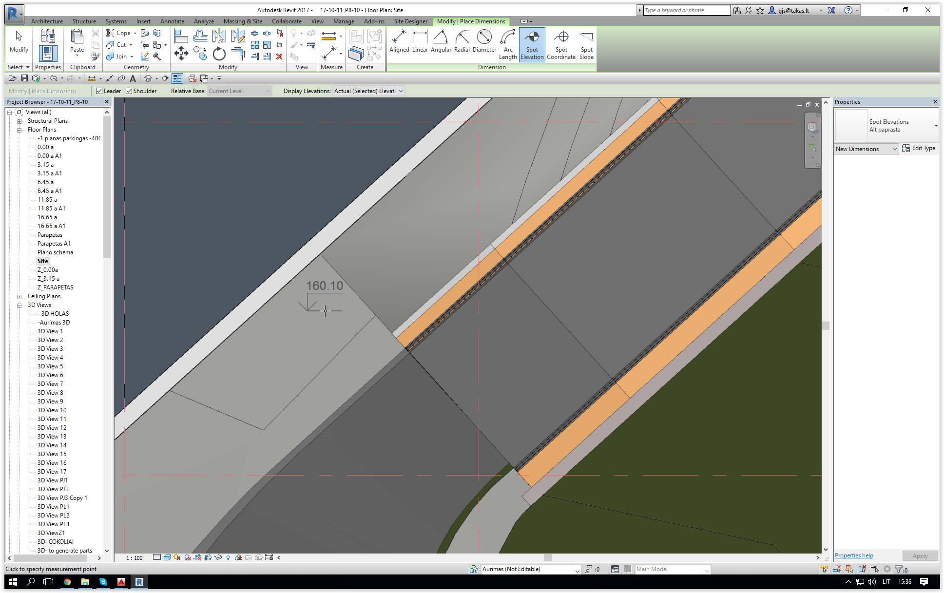

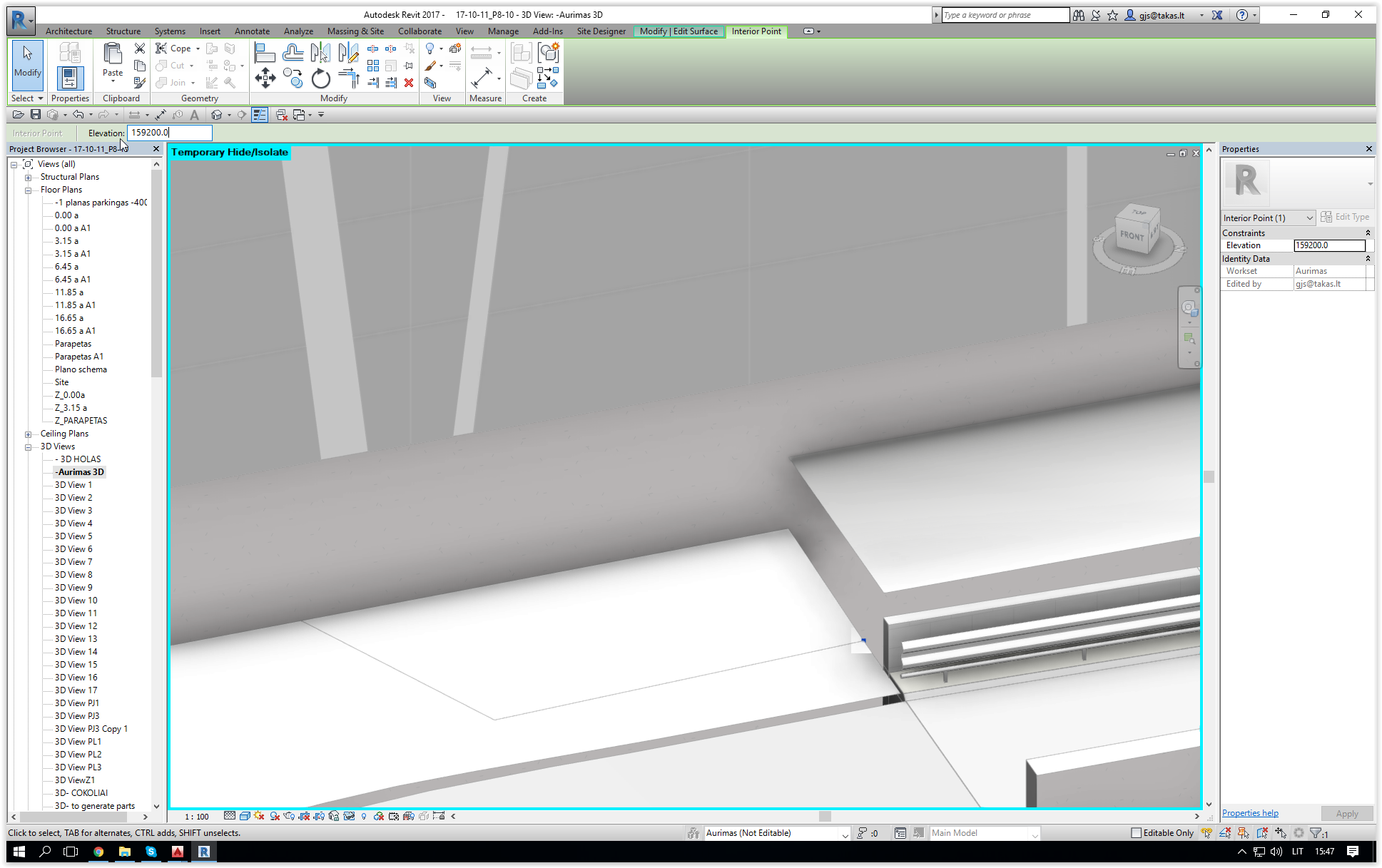

I have similar problem. All these two surface altitude is 160.000 but how you can see, the right one is one meter higher? why? And by the way, when I modificating toposurface, the surf point is 159200, but when I check it with sport elevation it show that is 160100. Why is that?
155872_Screen_Shot_10-11-17_at_03.47_PM.PNG155872_Screen_Shot_10-11-17_at_03.36_PM.PNG
Thu, Oct 12, 2017 at 8:01:15 AM | topography not being generated at the correct level
#11
Put a tag on both surfaces....Also, check your rounding settings on your elevation tag.
