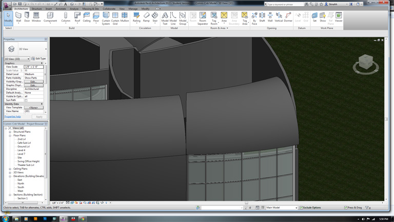

Hi All,
Im very new to Revit (about 2 weeks in) self teaching.
I am currently working a curved roof form that I have created using Component-- Model in Place  method. I called the component a roof, then used the sweep blend tool to create the path and profiles. Thats all good and fine, however, I need to create a second  Component-- Model in Place to complete the form.
Heres the problem, the planes in which the sweep blend tools create do not line up with one another-- in other words the two components are not on equal planes.
I have tried to mirror the first sweep blend and the modify the path and profiles, but that does not seem to take.
Is there a way I can join the two compnents together??
Thanks for any help!

Are those "profiles" the same? if so use SWEEP tool, not swept blend, in this way you can create one single PATH and you have that in one piece and not two like you have right now.
