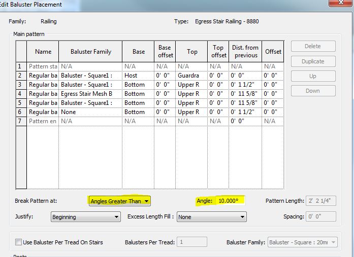

One property of the railing confused me.
Brak pattern at > angle greater than> angle
This angle is the railing turning on the horizontal plane or on the vertical plane(like the railing bending at landing)?

Wed, Nov 28, 2012 at 4:57:58 PM | one proeperty of the railing
xixiha
Joined: Sun, Jan 31, 2010
77 Posts
What you have posted is not what I am asking, see attached image, and I read the help before I ask, but the help didn't help me.
It says:
Break Pattern at The point along a railing segment at which the baluster pattern stops. Angle A value specifying the angle at which a pattern breaks. This property is available when Angles Greater Than is selected for Break Pattern At.
 I did some test and inclined to thnk it means a the horizontal angle.
