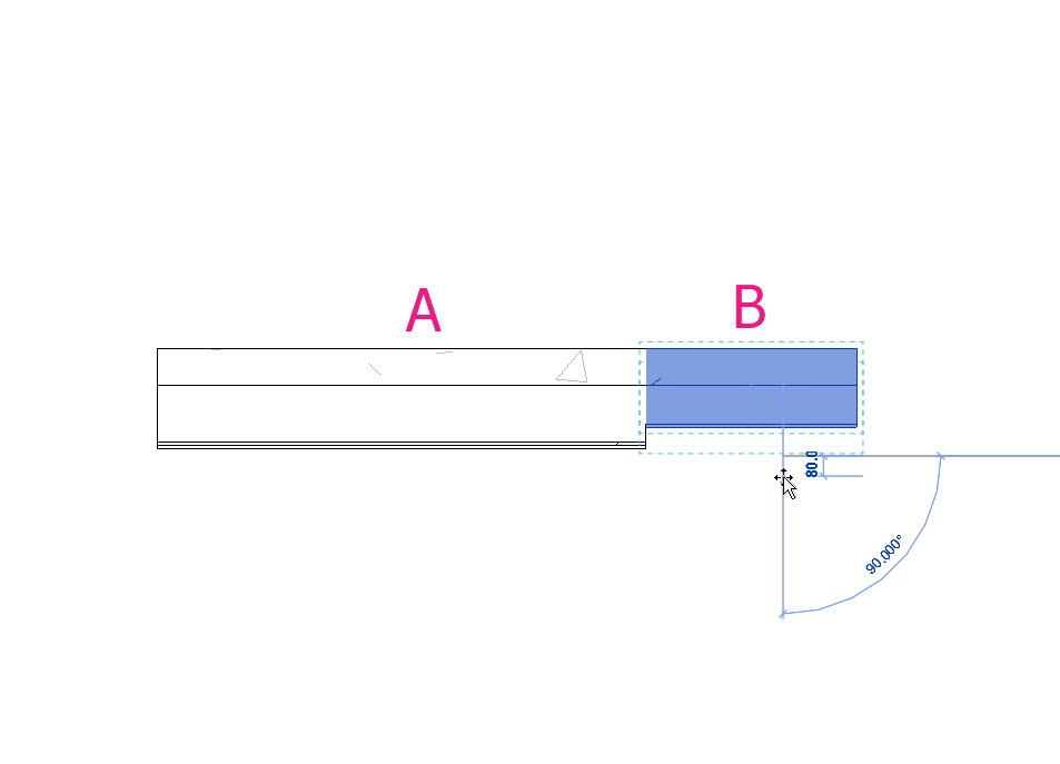

I draw 2 walls, one is thicker then the other one (please see the attached image)
Now I want to move wall B down a bit, but when I move wall B, wall A is moved at the same time.
I try to disjoint these 2 walls, however the gap needs to be at least 200mm (too wide) .....
Would you teach me how I can move wall B without moving wall A, please?
(Other methods than redraw walls)
Thank you very much

you must lock the wall A, than move Wall B to the position you want ,and then unlok the wall A.
Wed, Nov 28, 2012 at 7:07:28 AM | Revit 2013 Wall difference
Actually, just pick the wall to be moved and check the options bar box to disjoin.
NOTE: if this wall has any associated dimensions or tags, then the disjoin will cause you to lose these intems.  In that case, I usuall just pull the wall back so that it disjoins, move it, then stretch it back.

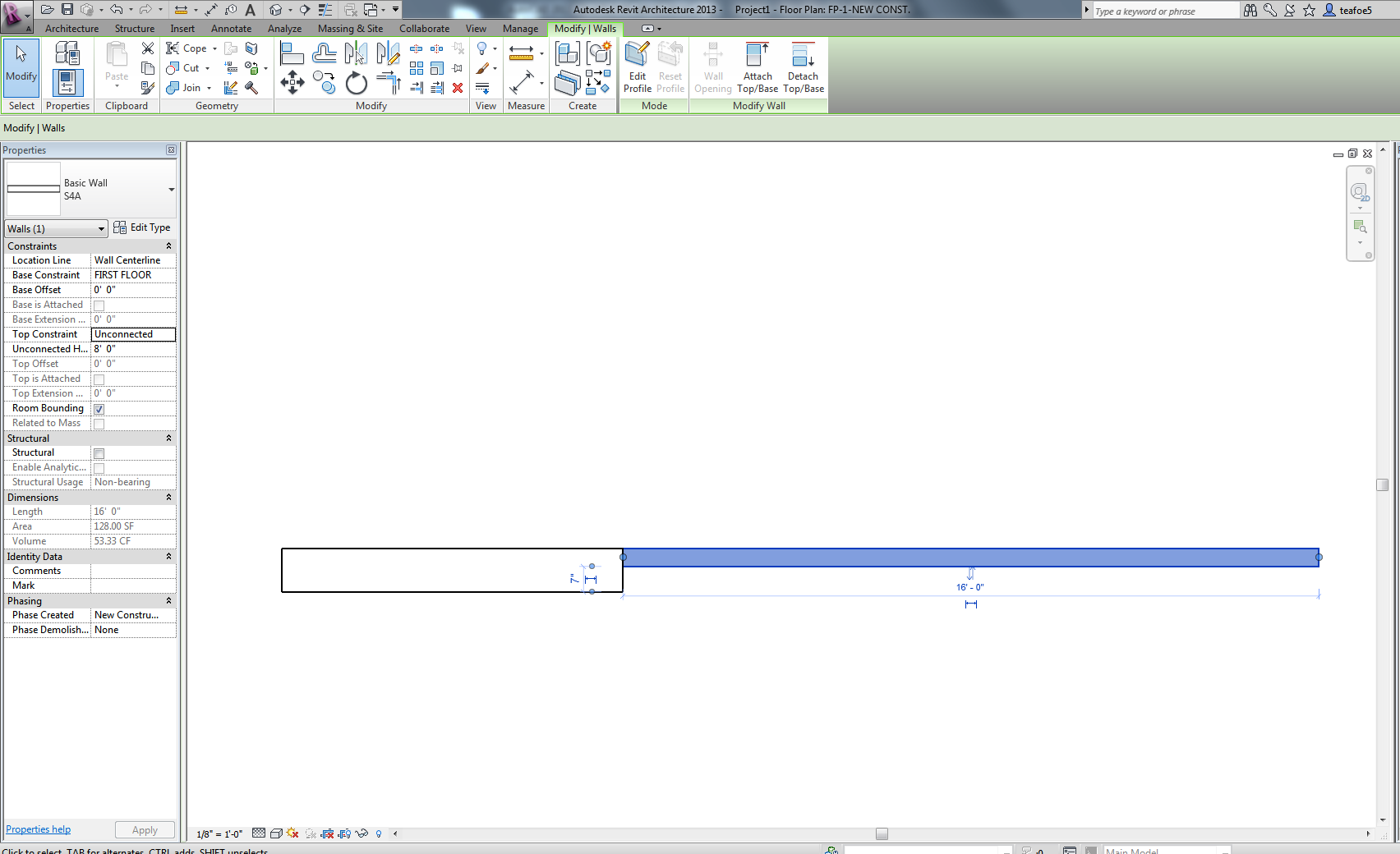

"I usuall just pull the wall back so that it disjoins, move it, then stretch it back."
This is the way I do it also
"just pick the wall to be moved and check the options bar box to disjoin."
I don't get that option on my option bar, am I missing something WWHub?
Wed, Nov 28, 2012 at 8:57:47 AM | Revit 2013 Wall difference
You did not pick move....
