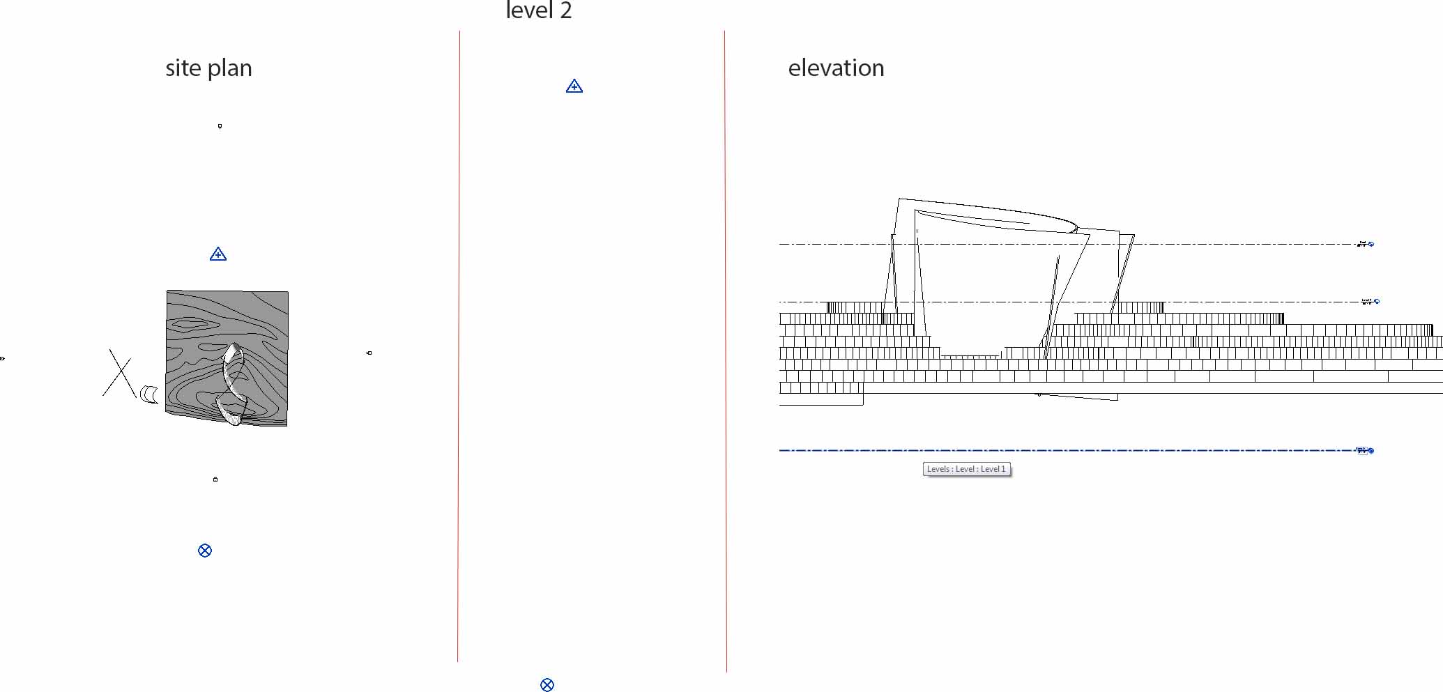

i imported a plan from autocad, and extruded contour lines, and i have these stepped contours. and i just moved them up 60'. i couldnt move the 1st level up to where i want it, so i move 2 other levels up, and it will not show anything.
i hope youll be able to see the photo, to better explain it.

Adjust 'View Range' from the View properties.
