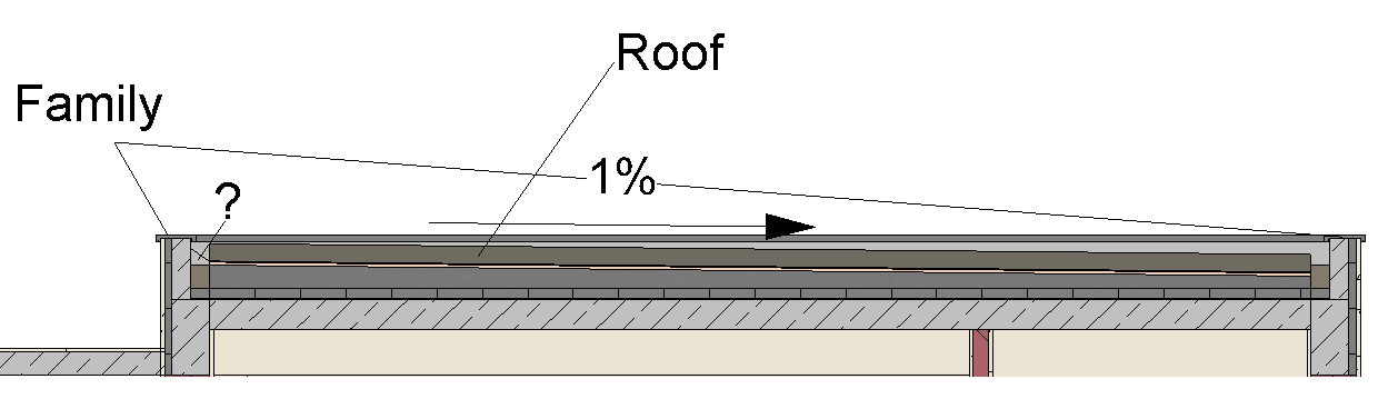

Hallo everyone,
i am tying to do a roof and seems tha i have a problem that i cant solve.
I did this roof with a family and a roof tile, you can see on my foto..
the problem is that my roof has a slope of 1% ,and at every side of the roof i need to make a triangle mortar, (on the photo i have set a question mark.)
i was trying to do this in the family with a sweep. but the only thing i could do was to set this triangle at the 4 sides of the roof with the same height.
I need tha this sweep changes its heigt at every site of the roof inorder to follow the 1% of slope
is there any way to be done?
sorry about my english, i hope you understand what i wantet
thanks

i thing you didnt understand me
i mean i wanna do this thing
at one site the tringle has to have a height of 15cm and a the south site for example 5cm

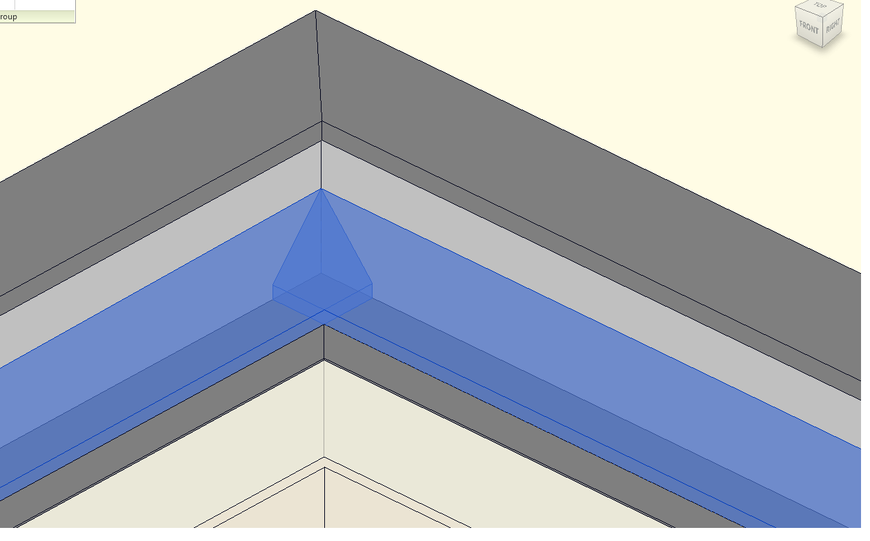

That image is more clear than the other, you have to create that in four pieces with In-place > SWEPT BLEND (two profiles), you'll have to use VOIDS to cut the corners.

with the roof modeling i cant really do what i whant to build Sad
I used to swept blends with difrent heighs and come to this thing
how can i connect them at the corners?
thanks...

Try Join Geometry

it seems to work
thanks a lot people Smile
