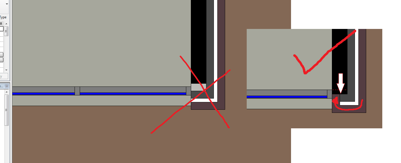

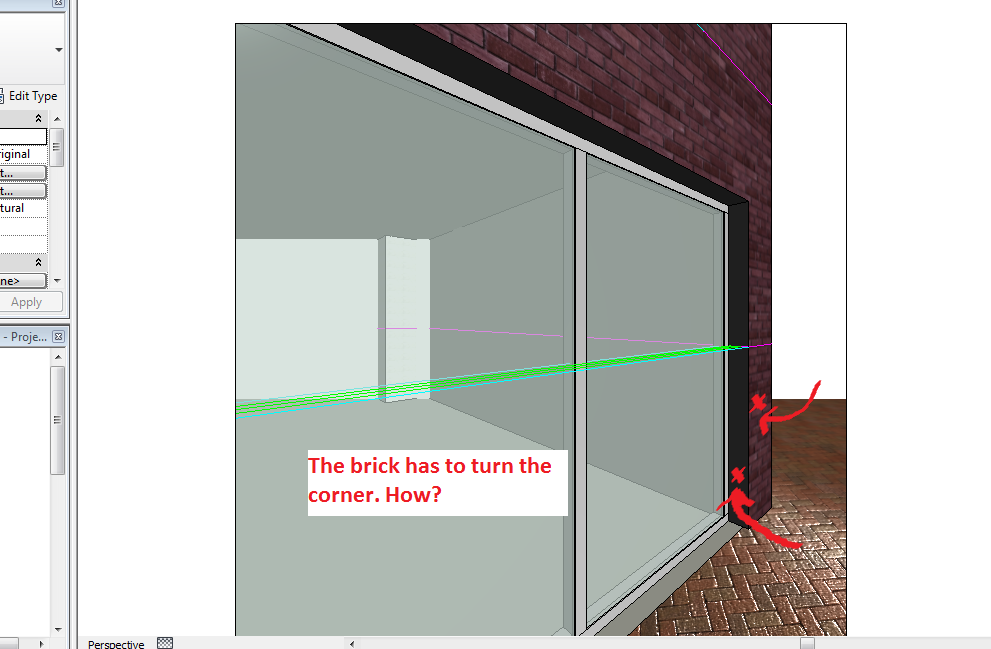

I'm having troubles with the corners of my walls. I want them to turn the corner to finish well. I did play with the wrapping options via the properties menu, but no results... It changes, but not the way I want it.
Just look at the 2 pictures I've attached.

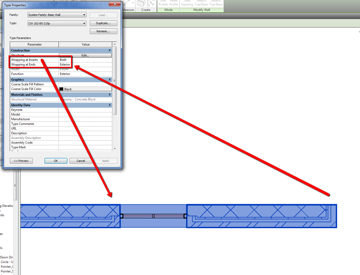

Select the wall then "Edit Type" - "Wrappint at inserts"

Looks like you are using Curtain wall.
