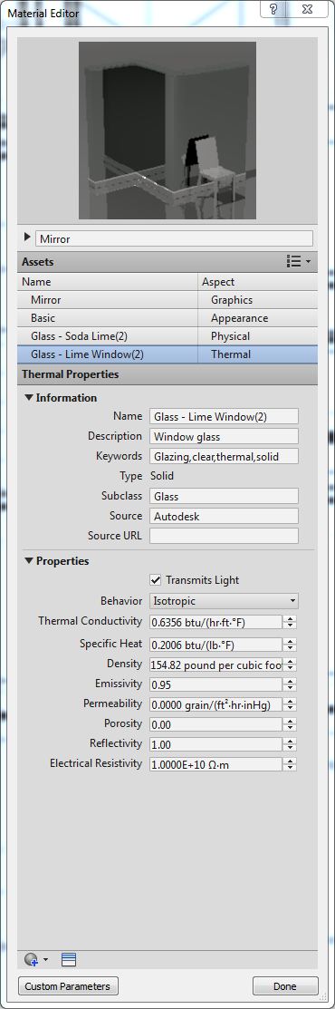

I created a simple extrusion for a mirror. I applied the out of the box mirror material to the extrusion and it does not reflect whatsoever in a rendered view. I've toggled the reflectivity of the material, but there doesnt seem to be anything else that would make this function properly. I've also tried downloading a mirror and it also does not work. What am I missing?

The material was applied in the project. I did not do anything to the material other than select "Mirror" material. What could be wrong in the material? I think you hit on one issue with not reflecting behind the camera plane, but I also tried different angles and still no luck.

I tried that setting. The values can only be set from 0.00 - 1.00. I've tried both extremes and still no reflections.

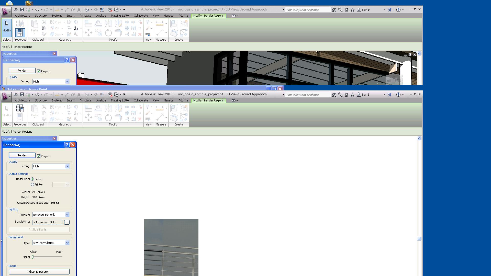

What were your settings for the material? I don't what else would be wrong in the model. If the material reflects it relfects. Unless the setting for the material has some issue, or there is a rendering setting somewhere that turns off reflections (I' don't know if there is such a thing). In terms of process, if I created an in-place mass that is extruded from the floor level and I apply the material to it, what would cause the material to not work properly?
Thu, Nov 15, 2012 at 11:12:03 AM | Mirror Material in Revit not Working
#9
I just used the built in mirror material.
Better image ... you can jst barely see the edge of the mirror material
