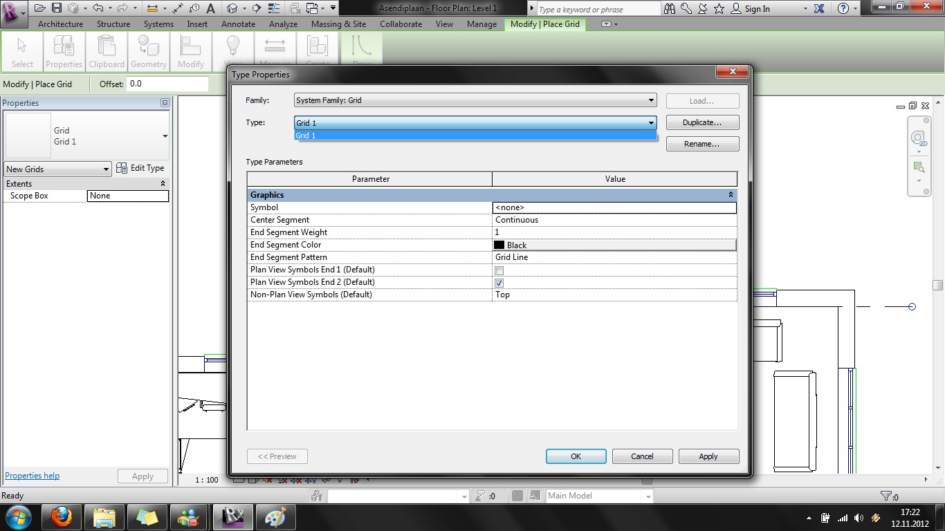

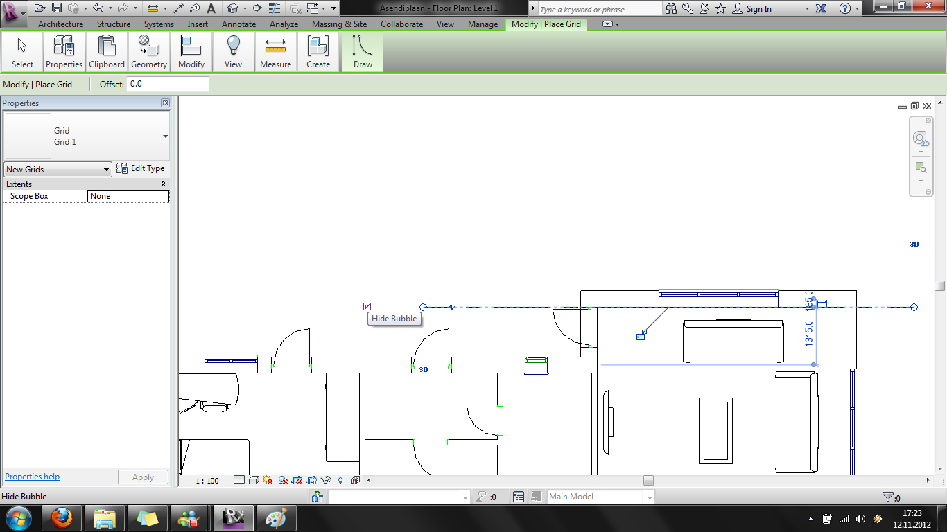

Hi! It seems like my gridline bubbles just doesn't exist, despite the fact that the box "show bubble" is labeled. I'm new in revit and have been looking for the solution too long already. Added screenshots too. Any help?

Try checking the 'Type' Settings. Click on the grid line, then edit the type in the properties bar. Under 'Symbol' ther is the
option of 'none' or of different types. If only the 'none' type shows up, you will have to load one.

Only the 'Grid 1' type shows up and the only symbol is 'none'.. How or where I can load this kind of thing ?

The Grid 1 is fine, but currently your screenshot shows that the Symbol is <none>.
If you click on this <none> you should come up with a drop down menu with the default Grid bubble as an option.
If not you will have to just load it. Just go to Insert tab, load family, and search through the standard revit files for one.

Thanks! Finally found it.
