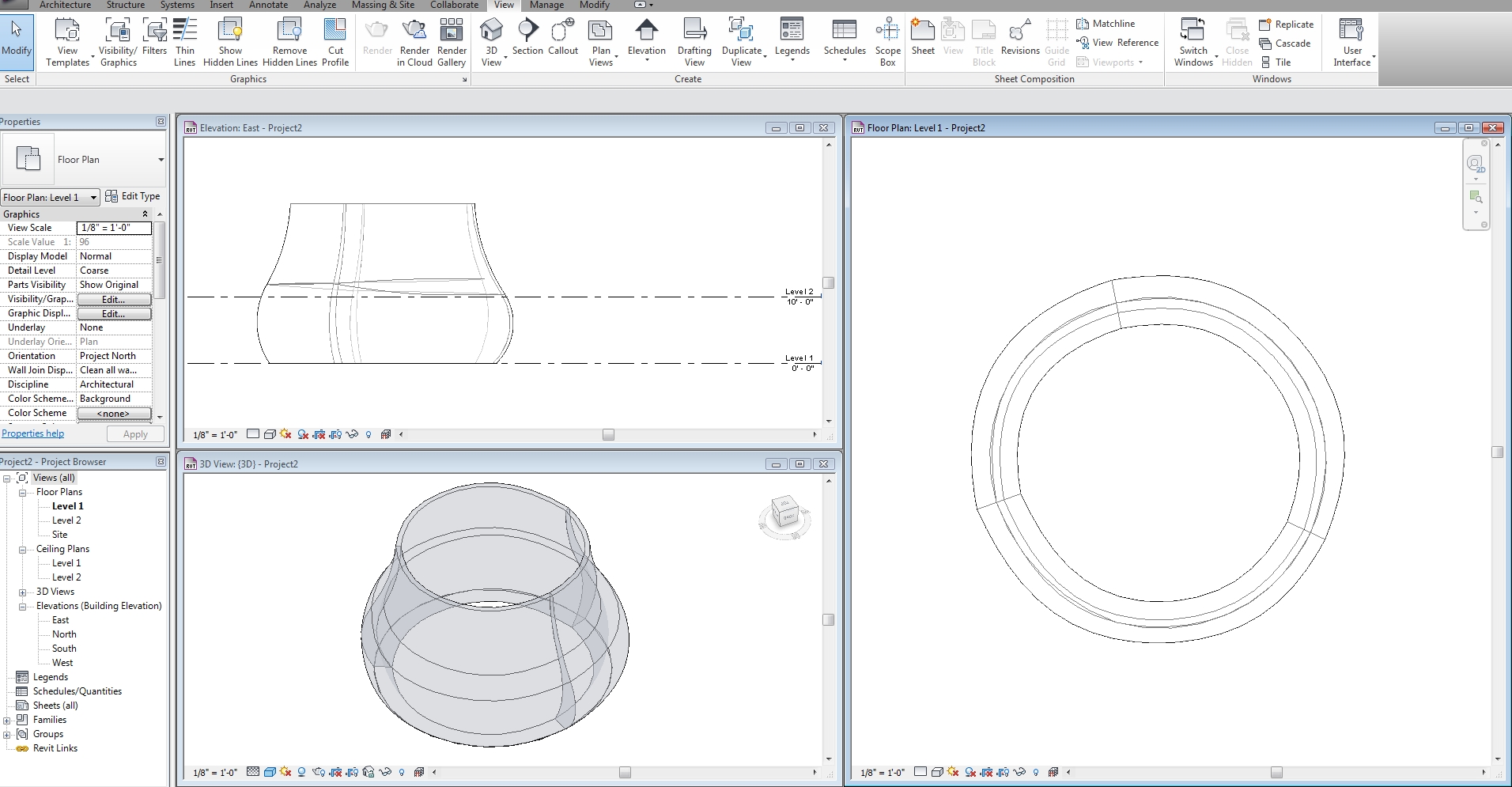

I haven't used massings much and could really use some help figuring out the best way to do this...
I had a concept for a cottage that I wanted to model in Revit.  I created what you see in the attachment as a mass family and loaded it into a new project (perhaps not the proper way to do this?).  I want to turn the geometry I created into solid walls.  The challenge is that no part of the profile of the wall is exactly similar - so, converting the faces into generic walls won't work.....
How would you do this?  What would be the best way to achieve the desired outcome?

You can do wall by face but each portion that has a different wall will have to me just that part of the mass.
Your really doing this backwards.  A little time spent ahead of time understanding the software is always an advantage.

As I said earlier.
"You can do wall by face but each portion that has a different wall will have to me just that part of the mass."
That means multiple mass families - not one.

This can be done in one family; just draw the curves that define the walls in three horizontal planes, create form (just surfaces) load into project, do wall by face.
