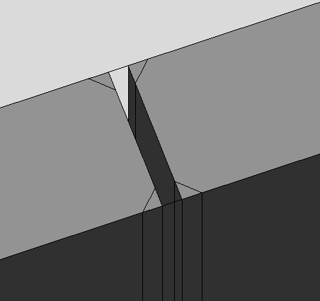

Obviously the curtain wall panel type is not as flexible as I'd like, so I've switched to a basic wall panel and I get the behaviour I am looking for (in regards to profile editting etc..). Now I tried making my own mullion profile to cut the chamfer out of the panels.. But it's not creating a void, or cutting the walls panels. Obviously I'm using the wrong tool. Any hints where to go from here? I've attached a picture of what I'm getting:Cheers

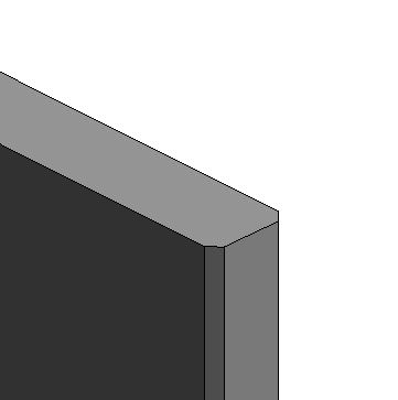

Well aren't I the popular one? I'm trying everything to get this going right. The final version I would to reduce the volume of the wall in schedules and so forth, but for now I'll be happy with getting it working. Latest attempt is a Metric - Profile of my chamfer (I created 4 versions around the insertion point to find the correct orientation). So I then made two Wall - Reveal types using the correct profiles and can apply them to the edges of a wall. It works, but I haven't been able to apply it to the Structure of a basic wall type so that I can use it as a panel in a curtain wall system. I know someone out there has the answer for this and heaven knows I've looked, but can't find it. Any takers? Here's my basic wall with reveals applied:

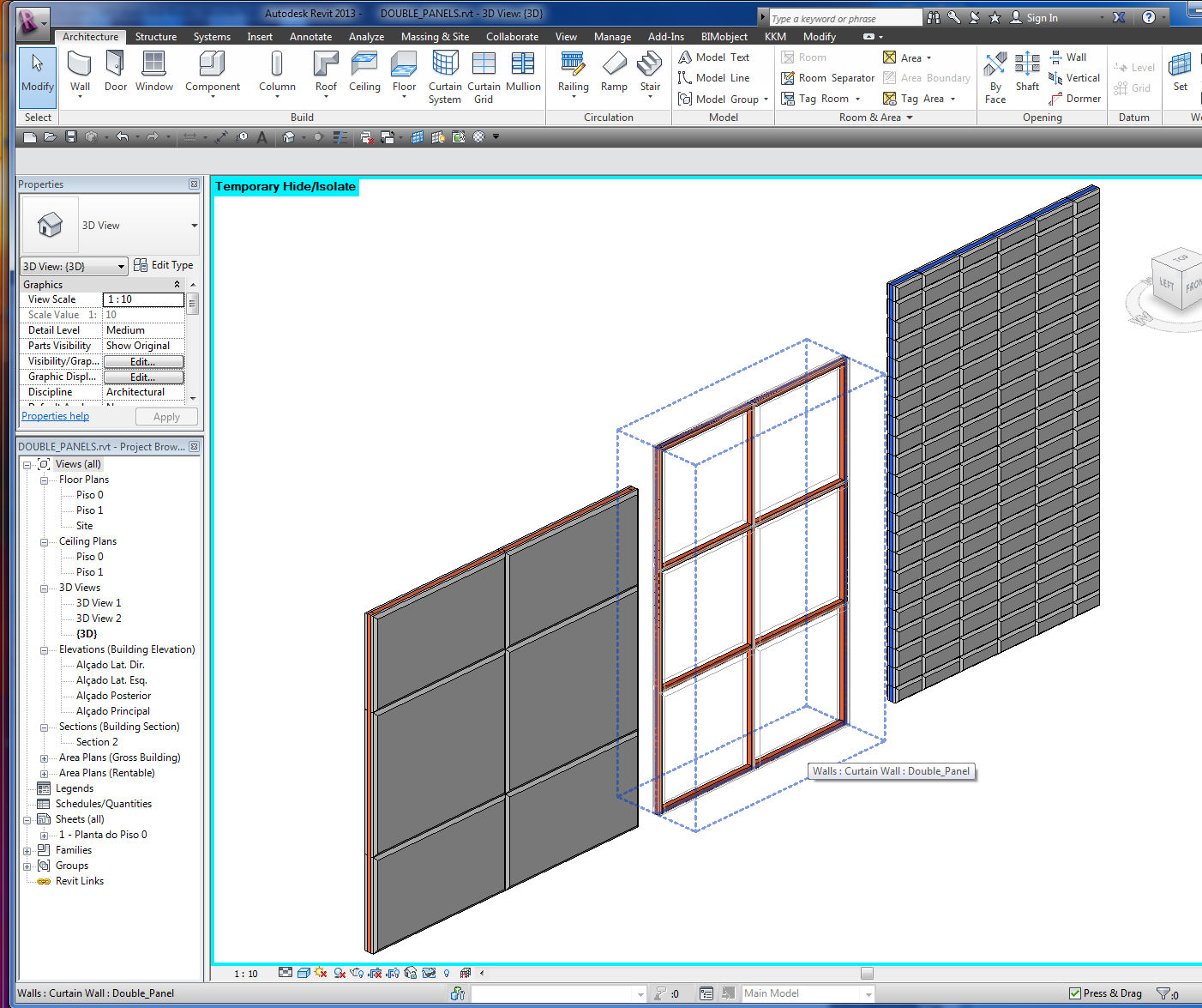

In my opinion, you were more on the right track at the beginning of the thread than now. You started with a curtain panel family, with  the chamfers and the gap. That's exactly how I have done, and it works.
Now you switched to walls with reveals? Now you are limited to what you can do in the walls' type properties window. The first approach of using the family editor gives you more possibilities.

A panel is just a rectangular panel. The panel adjusts its shape to the profile of the curtain wall. For example, when a curtain wall is attached to a sloped roof.
