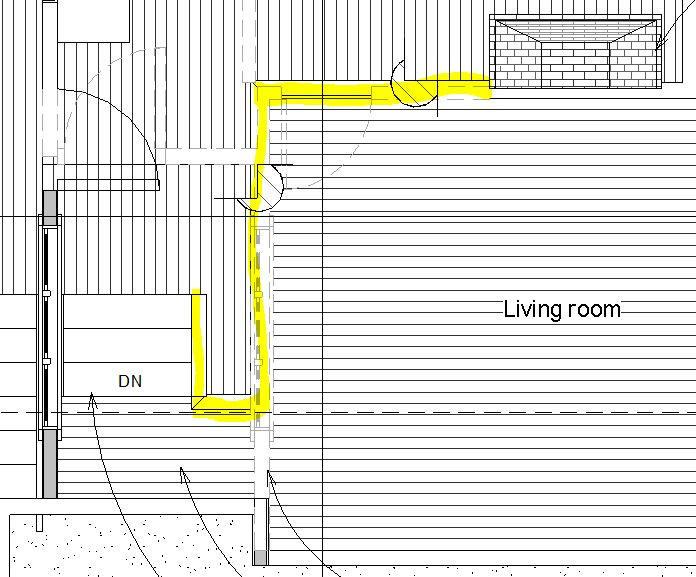

Hi Look at the image.
A wall that was demo'd out is replaced by a railing. but the demo wall obscures the railing. is there a way to get the railing to show OVER the demo?
The phase filters are all set the way I want. demo is dotted, but its not transparent

Mon, Nov 5, 2012 at 1:29:25 PM | railing hidden by wall demo
What about setting that wall to transparent individually?

Nice, didnt think of that. thanks! worked perfectly...still not used to altering objects VG settings individually I guess.
