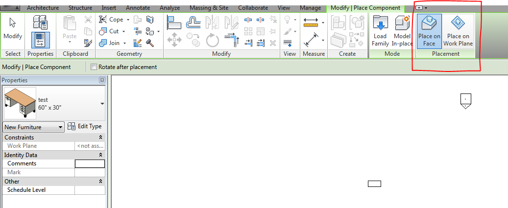

When I try to place some furniture, I can't place it unless I make a floor. But this is not the case for all furnitures.How do I change this restriction?

It depends on how the family was created.  You can go into the family if it is floor hosted component and select Work Plane-Based then you will get the option to place on a Face or on a Work Plane

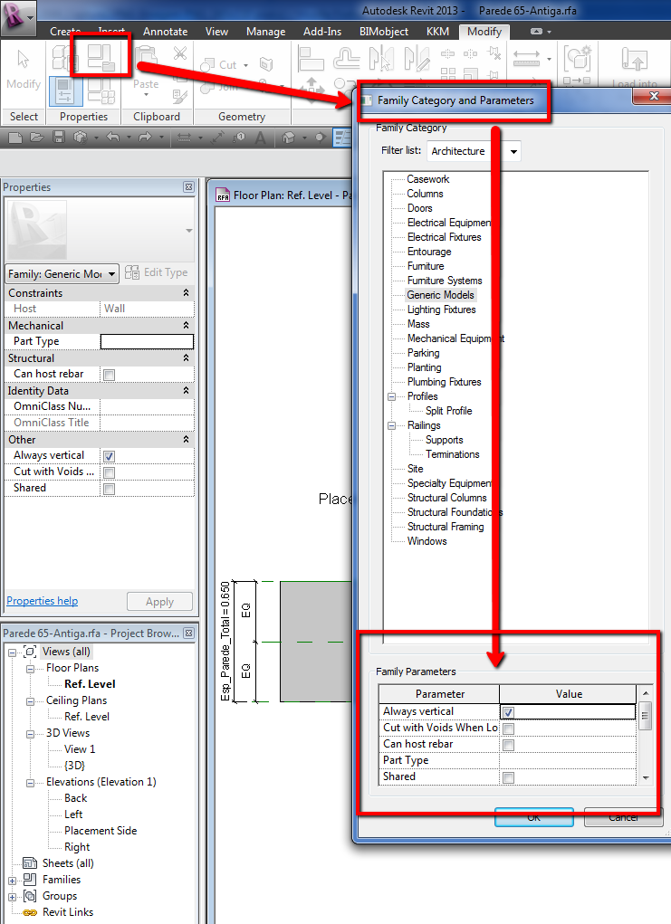

Go into the family as in? I can't find that option.
Fri, Dec 14, 2012 at 2:49:55 AM | Can't place some components without creating floors (REVIT Architecture 2013)
Joined: Tue, May 22, 2007
5921 Posts
4 Stars: 205 Votes
Edit the family then goto "Family Category and Parameteres".
