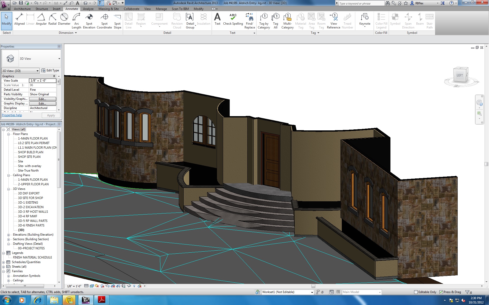

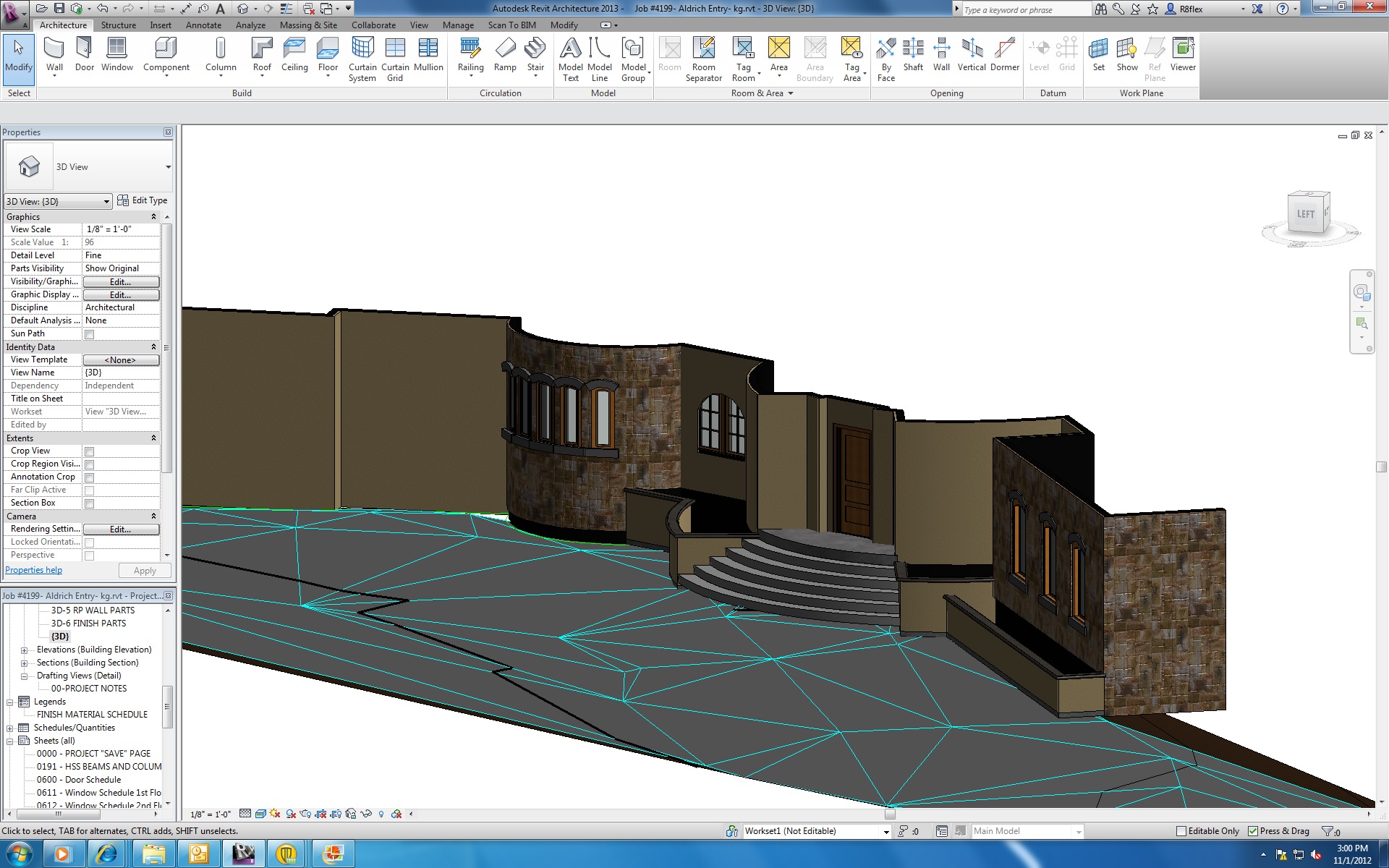

Hello-I sketched some stairs and they look great in plan view but very weird in 3D. I thought it might be a view plane or a cut plane with some interference but I can't figure it out. It renders through autodesk 360 the same way (with the glitch) so I've ruled out my graphics card. Help?Thanks

Hmm, not too sure, but if you look closely, you can see part of the landscape (well the white lines atleast) looking like they are raising over a bit of the stairs. try make a building bad under the stairs, and see if the problem still exists? just to rule out the landscape i guess. goodluck with it.

press vg, and make sure all imported or linked cad files are turned off

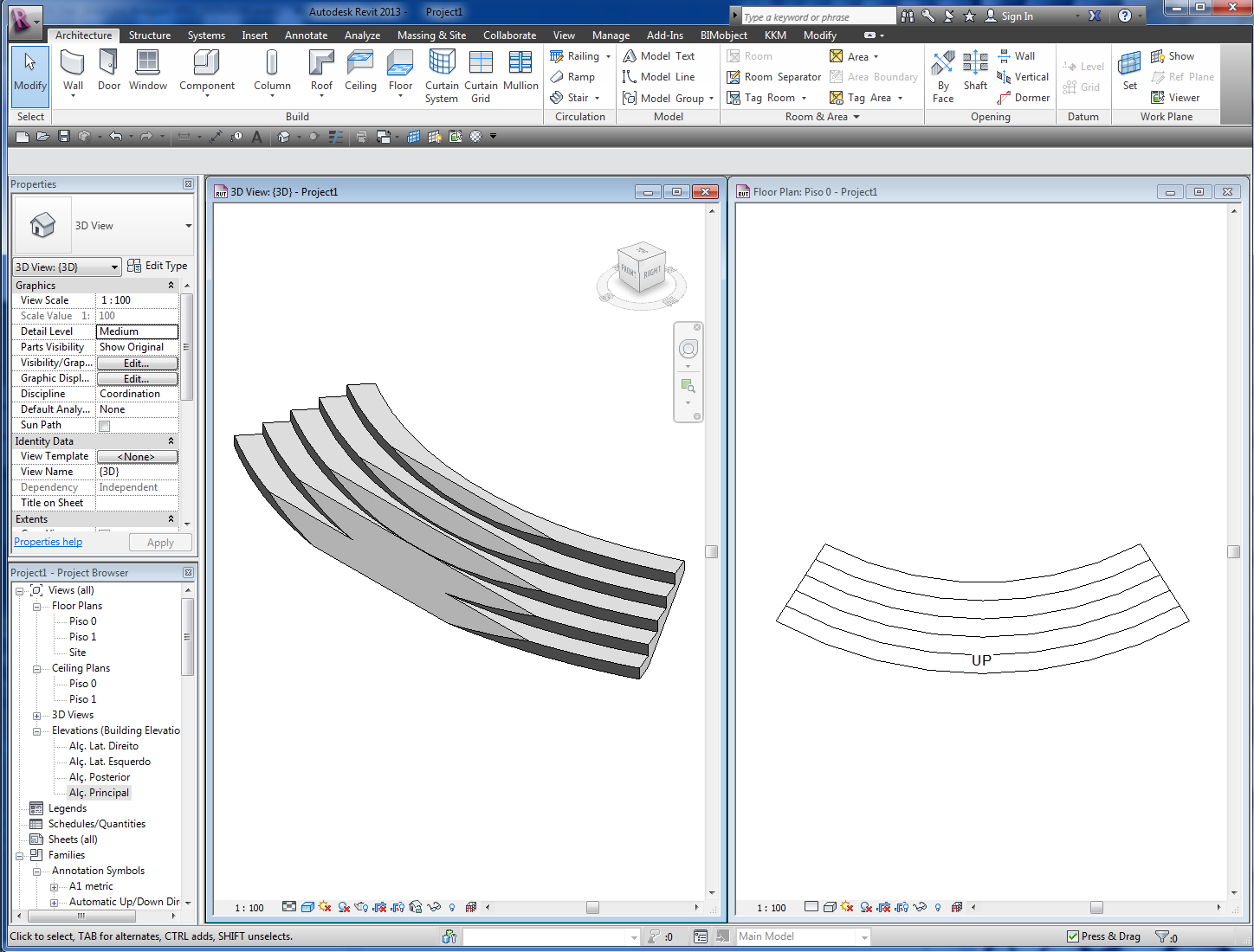

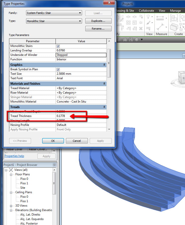

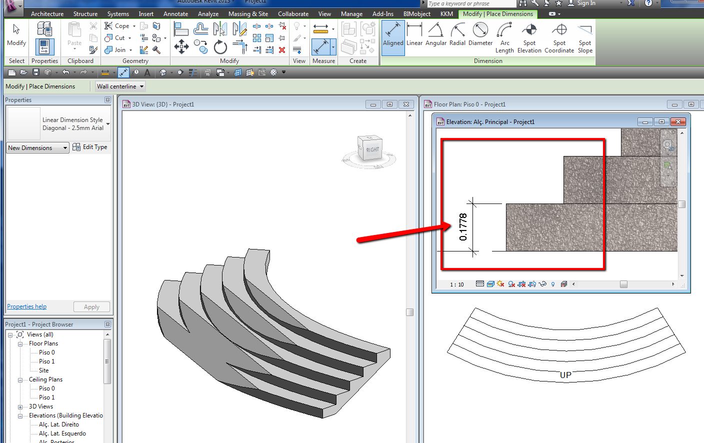

OLD problem with "Monolithic Stairs"....
Watch images attached to solve your problem...  Shadey

Thank you Typhoon! Smile

I've also noticed that there is a stair "run" setting for the bottom side of stairs, one slopes and one steps. On curved stairs I use the stepped run to avoid that problem. For some reason the slope bottom and curved stairs does just that.
