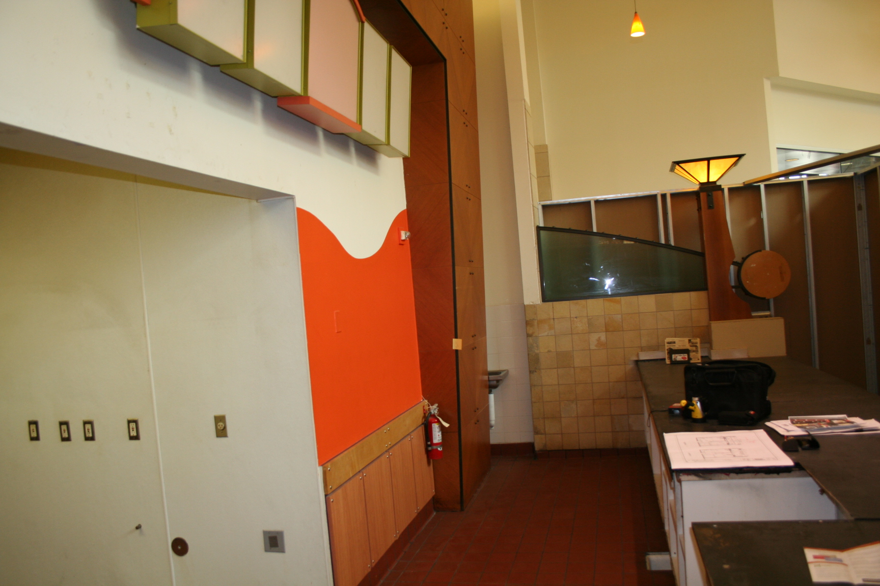

I have a accent wall made of wood that flares from 4 7/8" to 12", what is th ebest way to create this type.

I don't know if I understood your issue, that's why sometimes I ask people to post some images to clarify, maybe you are talking about "Stacked Walls" or you need to create an "In-Place" wall.....

understand, this feature is an accent to the store front in a shopping mall, it is flared from the bottom to the he top which is much thicker. i thought it should be a wall, therefore I could assign wood materials etc. refer to pic and thanks for the feedback. By the way I am stuck in 2009, no financial support.

I see what you mean... wall "In-Place" is the answer!
