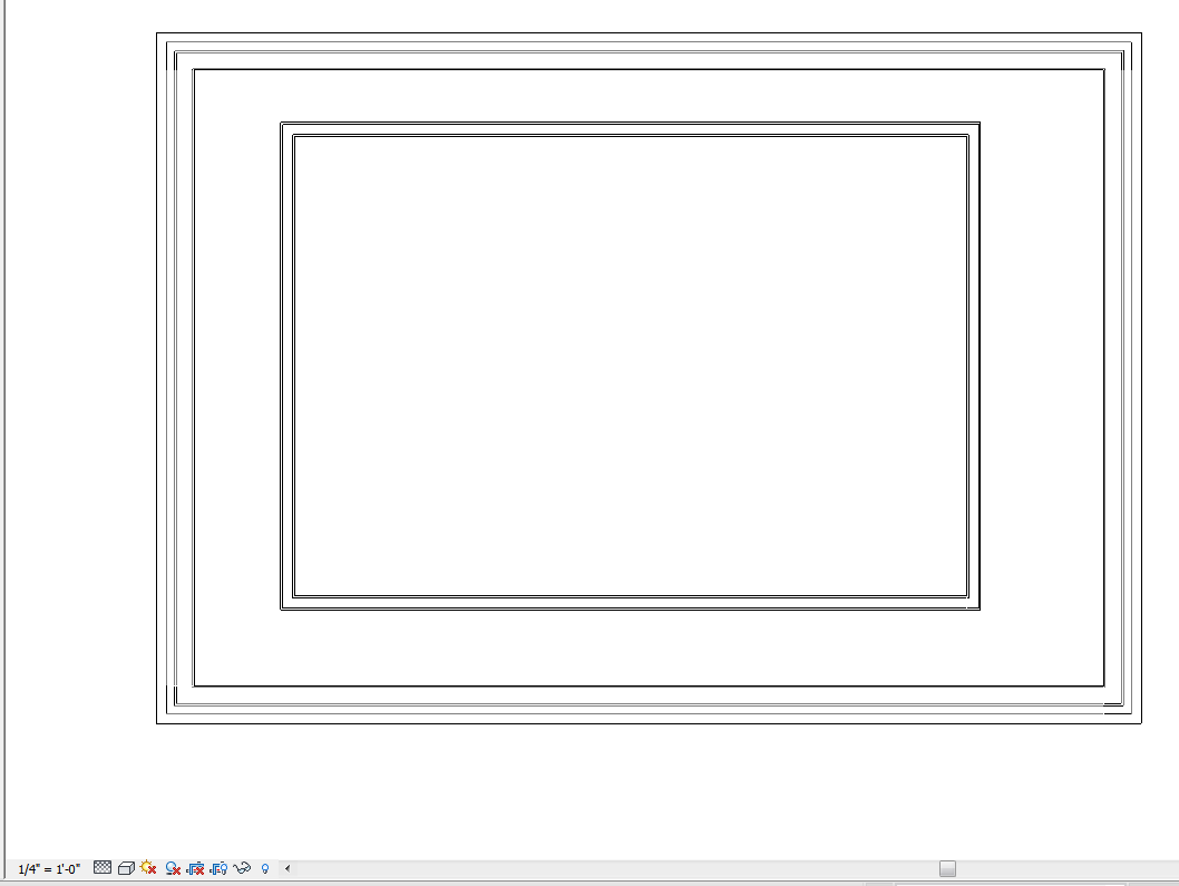

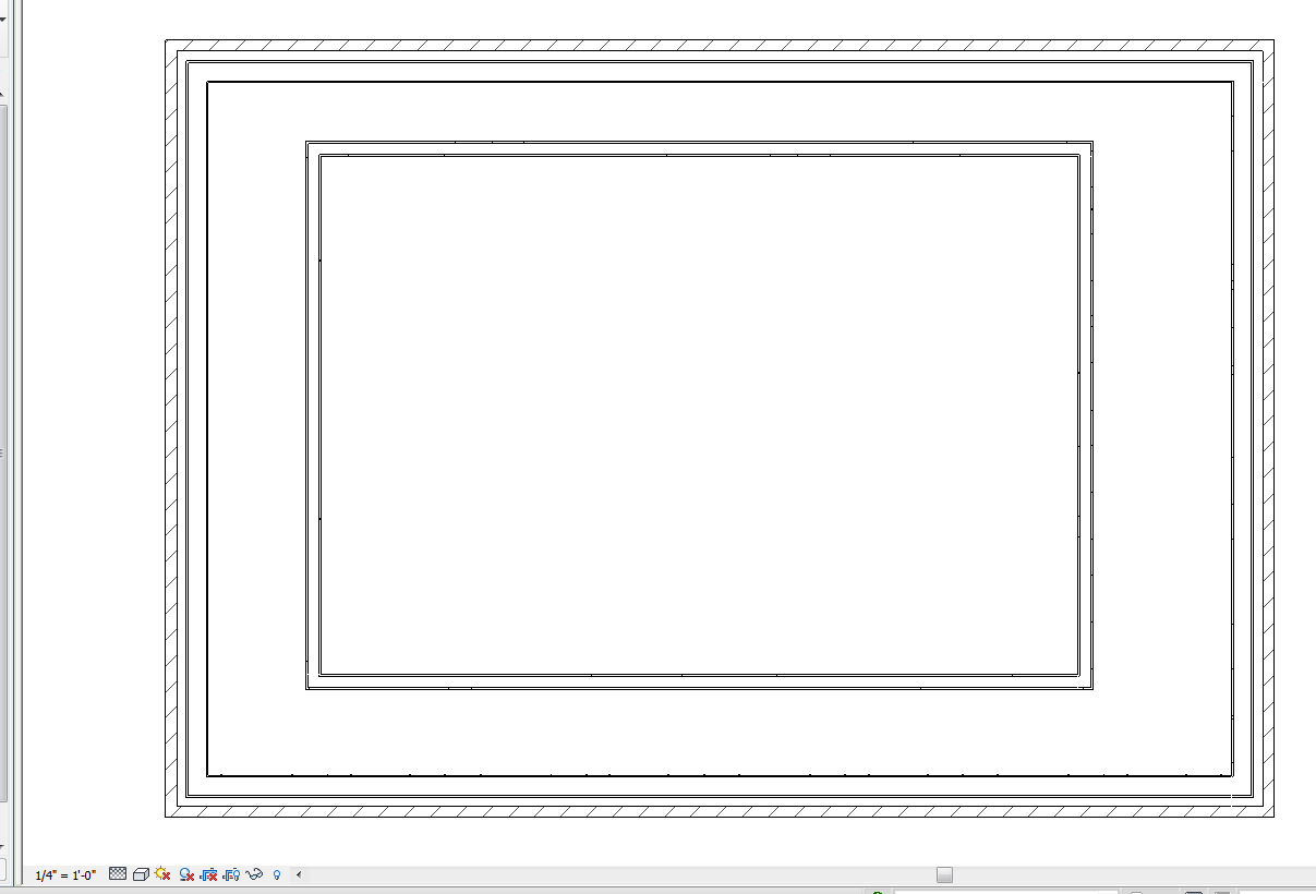

I need to change the detail level of walls in my floor plans. The exterior walls need to stay at a medium, and the interior walls need to be changed to coarse. They are on different worksets so I thought I could just use a filter but that isn't an option (in 2012). I can't even manually override the detail level. Any suggestions?

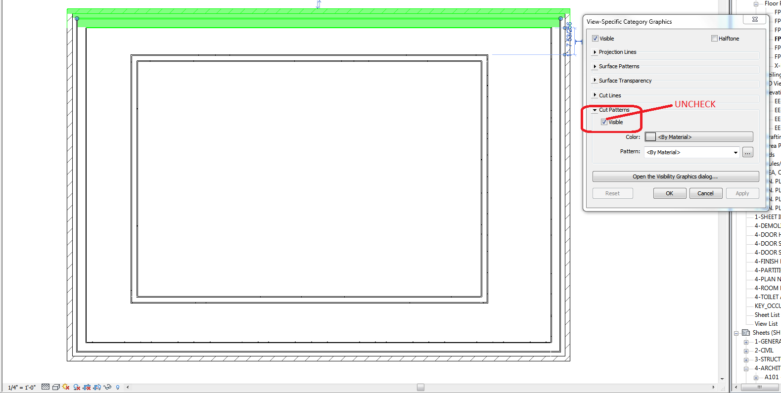

There is no way to have 2 detail levels on one plan that I am aware of.  What you could do is select the exterior walls and override graphics in view and change what you need changed on those walls.
