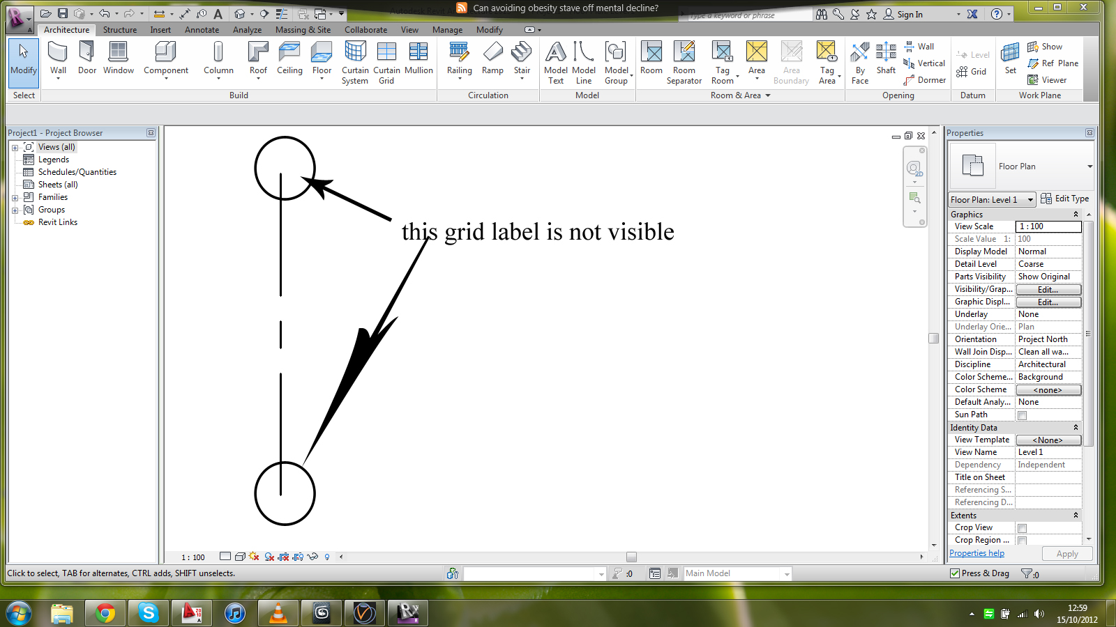

Hi.
when ever i start a new project i draw its grid - but when im doing it its labels arre not visible for example A,B,C.... and 1,2,3....
anyone can help?

If it is just the grid bubble that is not showing you need to change it in the type editor, if a grid bubble is not loaded you need to load one first.

nope not working - probably im not explaining properly.
let me attach an image - thanks btw

teafoe - its the grid bubble. can u explain that a bit please.
Mon, Oct 15, 2012 at 8:17:19 AM | Grid Labels not visible while drawing a grid
It appears that you are not using the standard grid head, otherwise the column line would be at the center of the bubbles.  Therefore, the problem is probably your grid head family and we don't know what you did.

WWHub is correct.  Try using an out of the box grid bubble and see if that solves your problem. Then look into how to fix your custom grid bubble.
