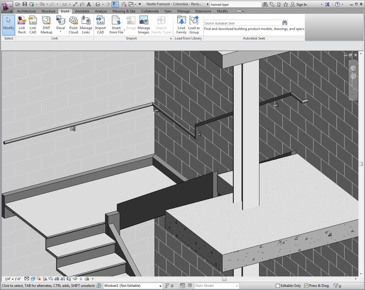

I am working with the new stair railing systems in Revit 2013. I have figured out how to show just a handrail, add the returns, and add the connectors but I cannot figure out how to stop the handrail at a landing. Does anybody know how to stop the handrail at landings?
I thought if I make the landings with the "same as run" radio button unchecked that would do it but it does not seem to make a difference.

Edit that handrail and stetch the line to the point you want to stop.
Here you have some videos about stairs and railings: http://wikihelp.autodesk.com/Revit/enu/community/videos/004_Architectural_Modeling/Stairs_and_Railings

Thank you.  Those were very helpful.
