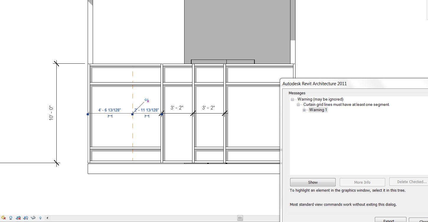

So i have looked but cant find this simple answer. I dont use curtain walls much but need to complete the store front.
how do you remove the curtain grid line? I get no options for that I can find.
Also, where are the options to change the size of the mullions. I select one and the types are all greyed out.

To remove the grid lines, click on one and on the ribbon you will see a add/remove segment. Click on that and then click on
the segments you want to remove. To change the mullion size, highlight--> edit type

Or you select the mullion and unpin it, then you will no longer be grayed out.

OMG DUh! Locks!! thanks, I was crumbling!
