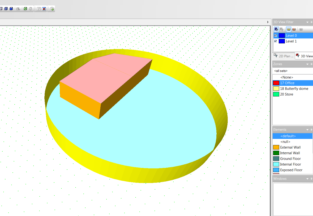

Hi I tried to export to gbXML and then import into two simulation softwares: Ecotect and TAS. Ecotect did not import anything and TAS manage to get something. Interesting is the shape of space....
TAS managed to import correctly set up room including:  shape, construction details, room names...

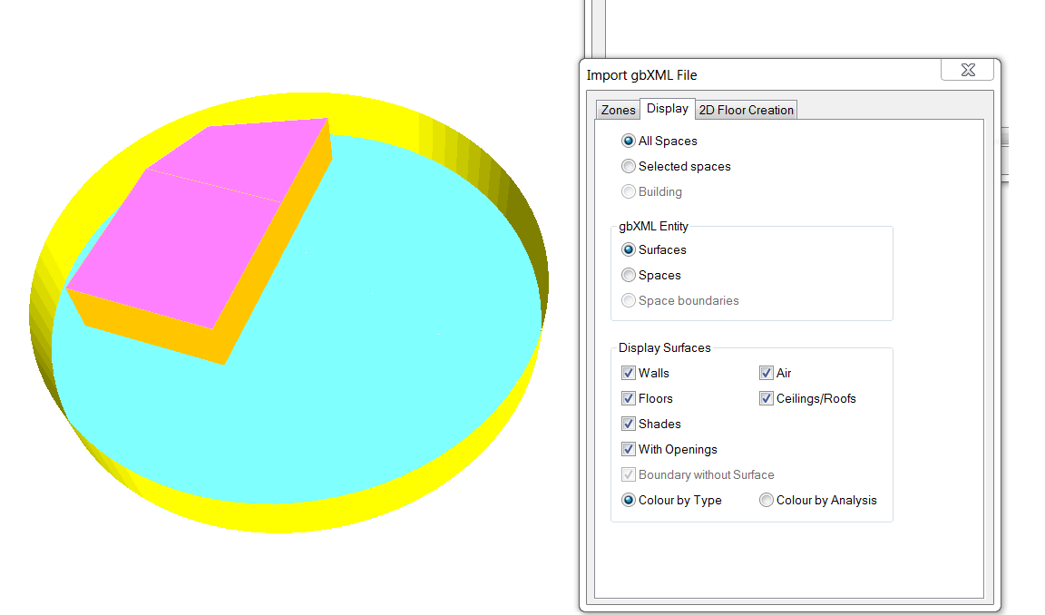

I tried also importing same gbXML to ies Virtual Environment 2012 and failed.. nothing was imported. See importing error and screenshots of all simulation version programmes
I would appreciate if anyone ever manage to add room to space that changing shape especially if that is not a rectangle type of space.
