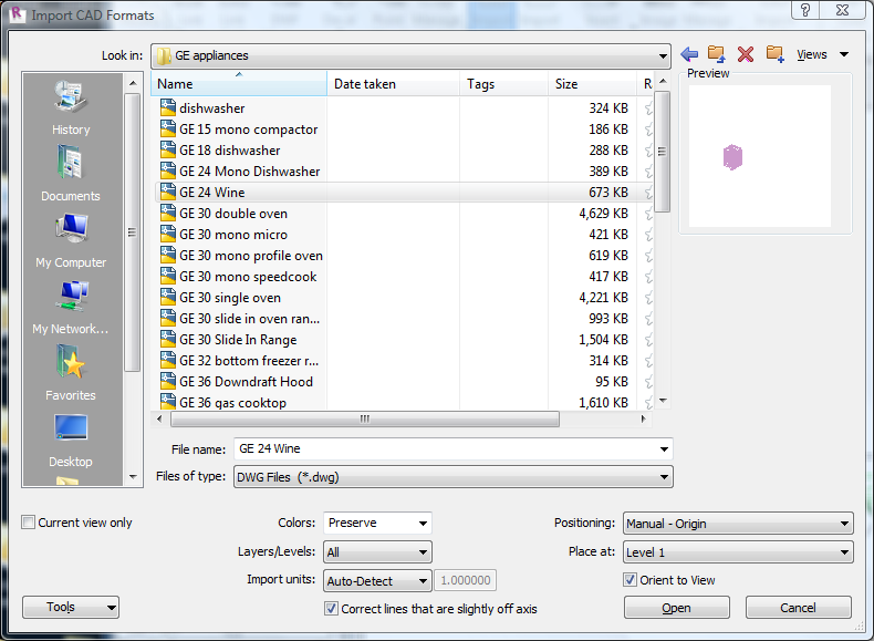

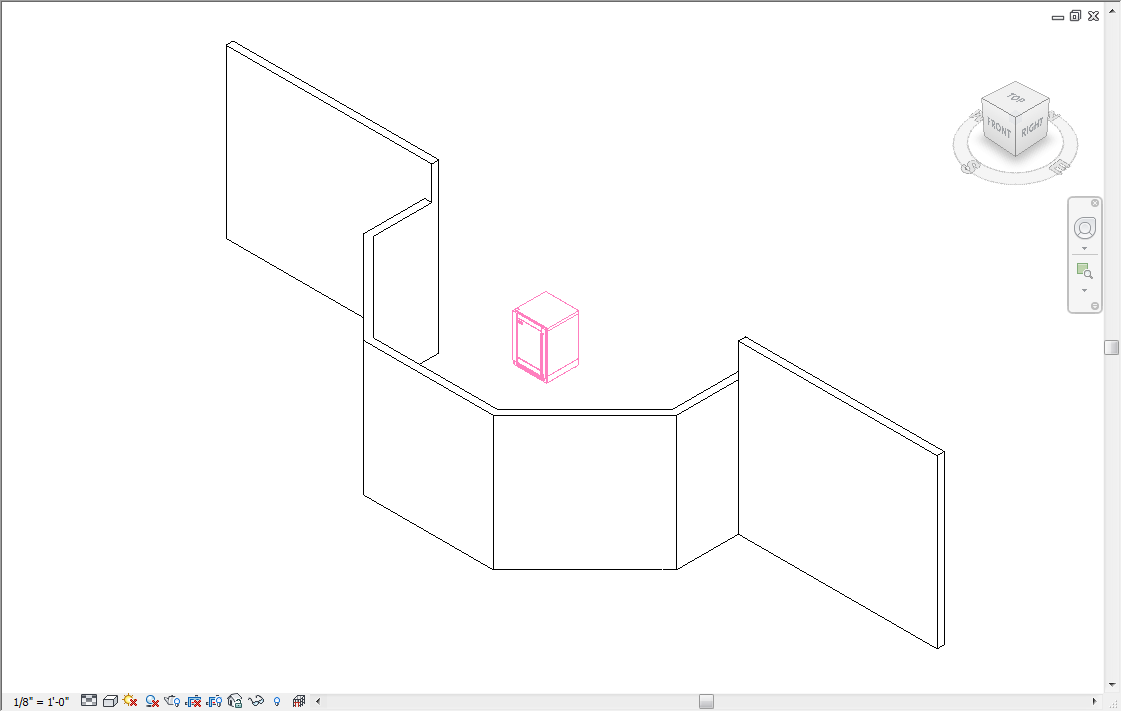

when importing you must specify where you want the object to end up. Note positioning, make sure you are in plan view, at the correct level, and I almost always use Manual Origin. I placed this wine cabinet in plan and then switched to 3D view.
