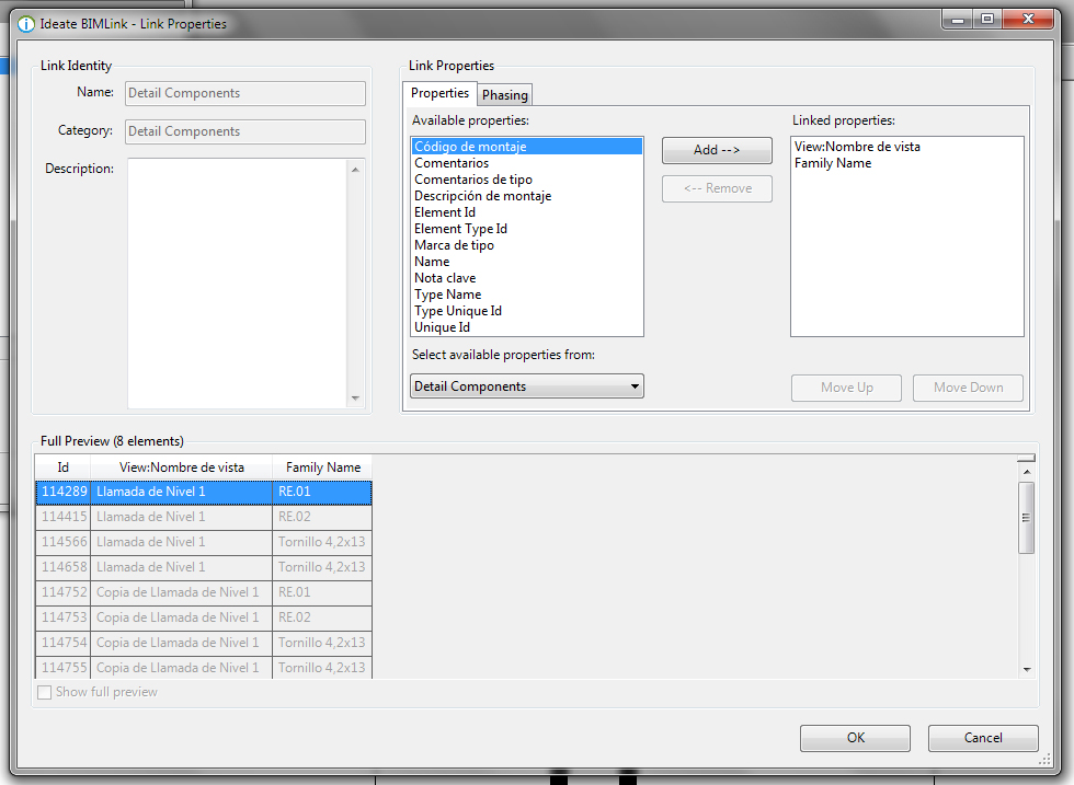

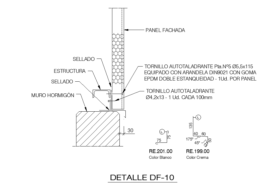

Hello good:I wonder if you can make a table of families picking "elements of details."Why?I mean, when I do a detail included screws, foams, sealants, etc ... all these elements I have done as families of "elements of detail."Now I want to collect these items on tables and include calculated values to determine the amounts thereof.If there is another way to do this would be grateful to anyone who could help me ...

Obviously, a 2D item placed in a 3D view can be scheduled but it will have no quantity, 3D information.  In other words, the quatity is one.  (Unless you place the element in other locations.)

How can you do?Thanks,I made the same question in Revit Forum and Glynnis Patterson, Architect www.ideatebimlink.com and I proposed to use application that is really good but ... charges.Before using this application would want someone else could give me your opinion so would appreciate any help on this.Deputy image obtained with BIMLink box, great application.regards,

We often use 2D model families that have parameters....For instance a furniture family that has only symbollic lines in plans and elevations.  We also have invisible detail families.  Just a family with an invisible line in it for place ment but it has all the parameters you need.  << Sometimes you might group this with another element so this information "piggy backs" to every place you need it.
tagging by "family name" and "family type"
