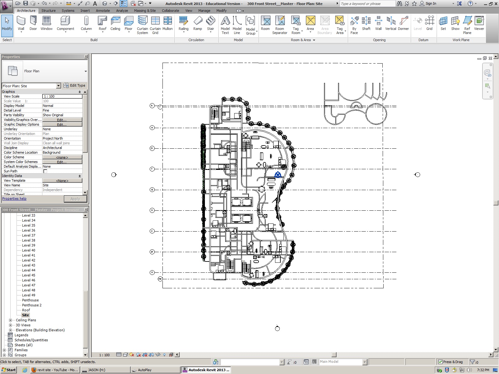

Hello,
I'm having a bit of an issue in my current Revit project. We're creating a 52 story highrise and any differentiation in wall placements throughout the floors shows up on our site plan. Now when we view our site plan there are many different walls from floors
above that are visible. Can anyone be of assistance on this issue?
-GC

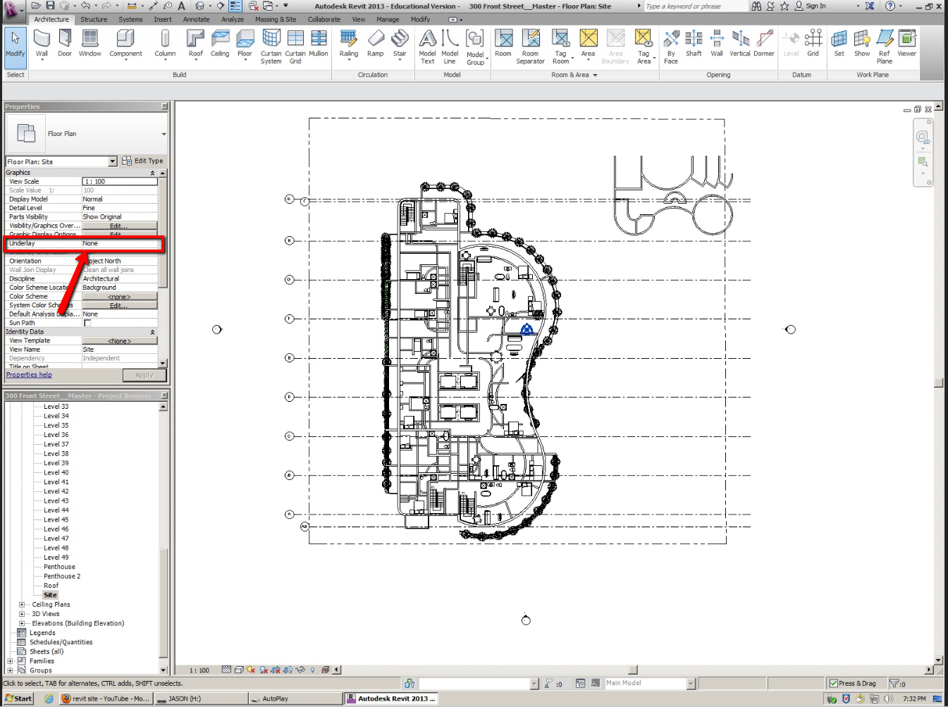

In that plan view change the "Underlay"

I think it is not the problem Ty (see image).....Mac, did you create a floor on that level?

Looks like maybe a View Range issue ?
For Site Plan views I don't usually want to see the inside of the building and usually put my View Range cut plane and top of view range well above the building height while leaving the Bottom and View Depth down to see the grade and trees.

Hey all,Figured it out, it was an issue with the view range. Thanks for the responses!
