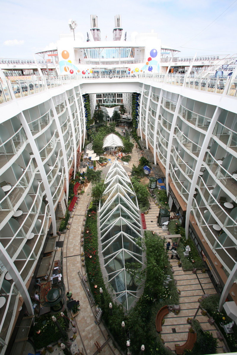

Well, I'm trying to model the shape showed in the image (the central skylight), sadly though, I haven't been able to model it, I don't even know where to start. I tried with Mass but I'm not been able to get there, I get similar results although quite different from the one in the picture. That's why I dicided to start this thread, because I'm seriously out of ideas. Thanks a lot for the help in advance Smile

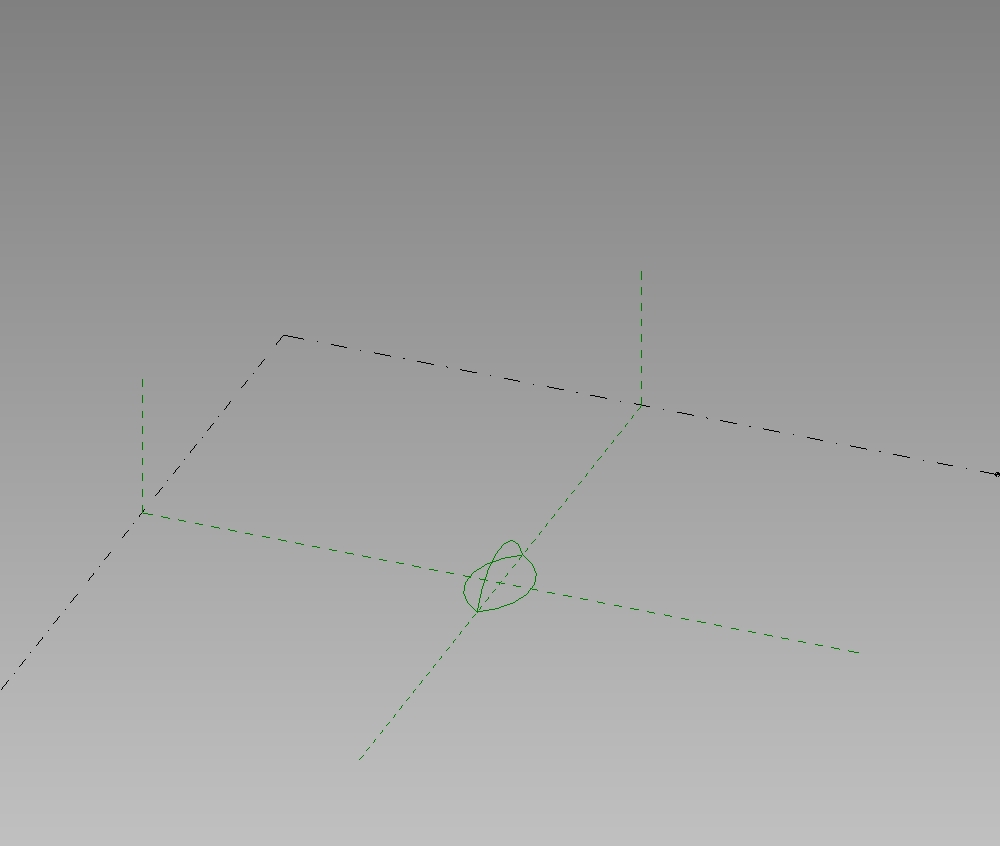

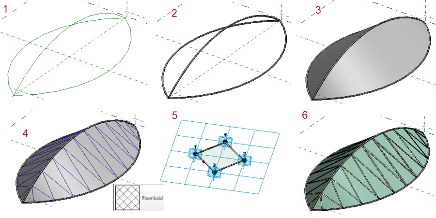

See illustration.

Thanks so much for both of the answers, I researched now a bit more on Adaptive Components and I think I'll get the hold of it it after a few tries, thanks (that's what I love about Revit you can try and retry as many times as you want with even worring about damaging your project).Thanks a lot for the illustrion I'll try it out right now and tell you you how it went but it looks amazing, again, I thank you guys so much. Smile

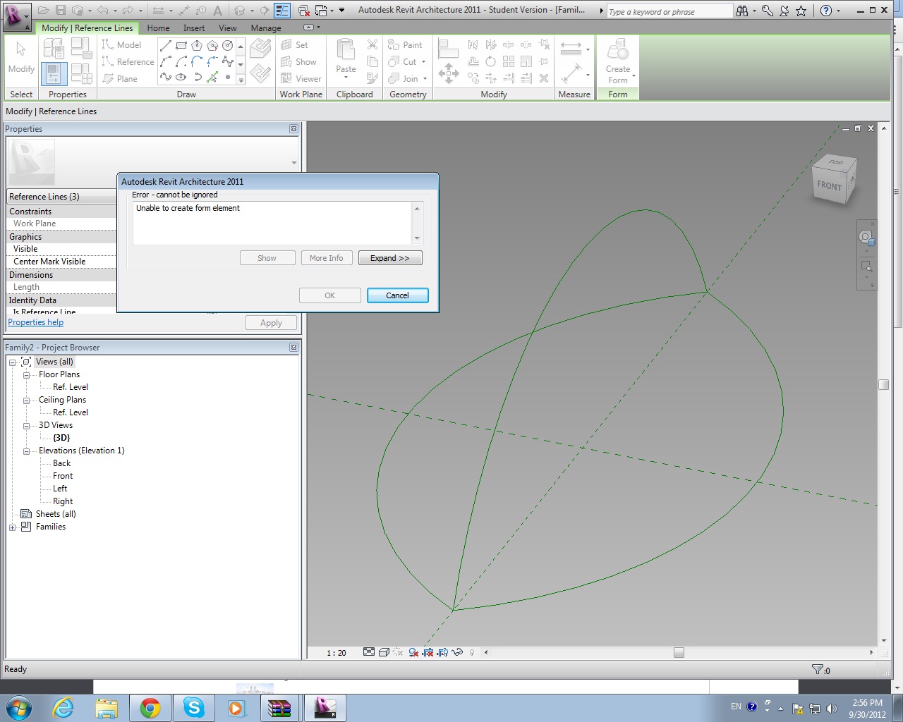

Well I tried to do what you did in the illustration but I ran into a problem, I got this message: "Unable to create form element", I probably did something wrong but I can't tell what I did wrong.

Do one half first, then the other. Revit won't be able to do both halves at once if you select the 3 curves.

Ah, alright, I did it and it worked thanks a lot for your help Smile
