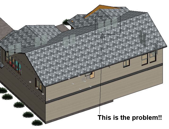

Hello,
I am having some graphic problems with Revit version 2013 Suite. See attached for an example. My desktop does not
do this. This only happens on my laptop that I just got. The laptop is a high end Asus machine. Has anyone ever seen
this or know of a quick easy fix? I am going to format this machine anyway and clean install everything. I am just in
the middle of a project right now and need this machine so I dont have time to format it right now. I just cant figure out
what would make all those weird shadows or whatever they are. They seem to be related to the actual glass on all the
windows. It doesnt matter if I use Revit's horrible windows or the pella or kolbe families...they all do the same thing. It
doesnt really affect the plans or elevations, it is really annoying though! It also doesnt look good when I am trying to
show the model to a client and it is doing that. Trying to figure out if this is a Revit problem or a video card setting.
Any help or advice would be appretiated, thanks.

Graphic card issue, update drivers and check again....

Yep, that was it. I got rid of the existing nvidia driver and did a clean install on the new driver and the problem seems to be gone now...thanks.
