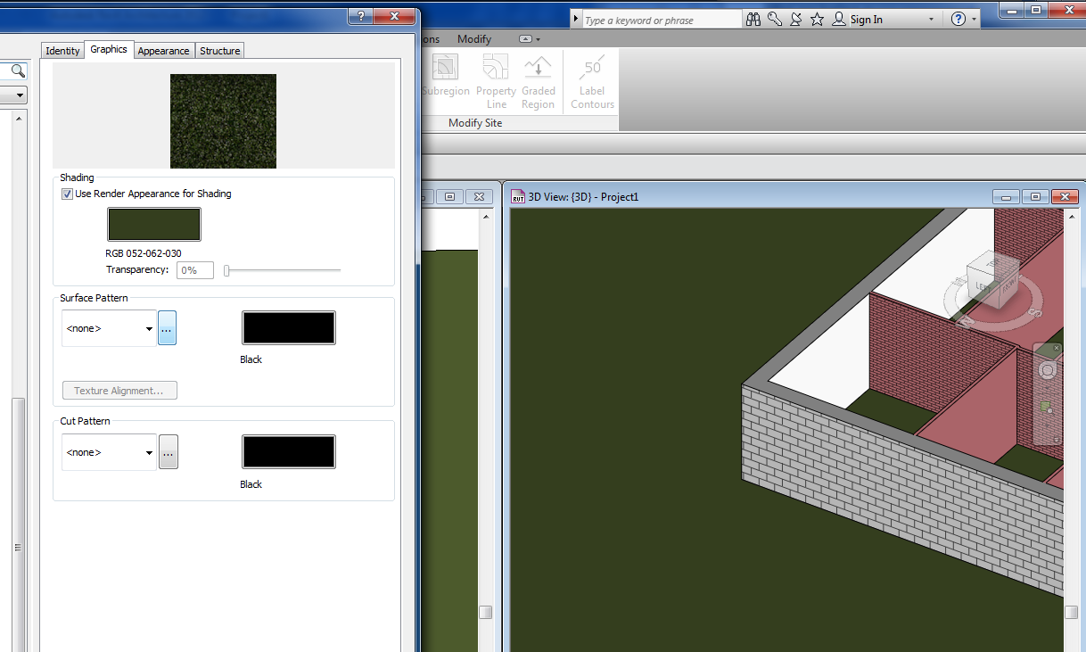

2013 revit- Grass  shows as materila on site plan comes gray color in 3d& camera view, any suggestion please

Turn On "Use Render Appearence for Shding" and make sure your "grass" is realy "grass"

Thank you but I already select ' render apparance' still comes gray in 3d . but in the site plan it shows grass!

sounds like a phasing issue possibly

it was actually.

Thank you for figuring out it was Phasing. I've been pulling my hair out, and even joined RevitCity trying to figure this out.
