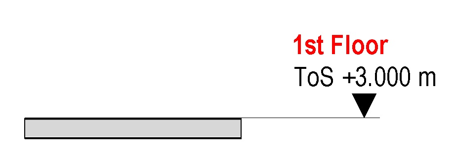

Is there a way in which i can create an instance text parameter appear above the level in a Spot Elevation?
i want to make a instance parameter above the level so i can write in wot element
(see attachment, Instance text parameter Indicatively in red)
Is this possible ???Thank you

yes ive tried to bring in a shared parameter but it doesnt show and im unsure whether im editing the correct family ! is it possible ????

Thu, Sep 20, 2012 at 9:27:50 AM | Customising a spot elevation question ? ? ? ?
Now you will find that this guy's solution only works with one text version.  No control.
So now for the rest of the story......
When you place a spot elevation, you have a choice for a prefix /suffix.....Had you noticed these?   <<Your answer is here.

yes but the prefix appears to the right of the level but i wanted the prefix to show above the level so it looks neater.

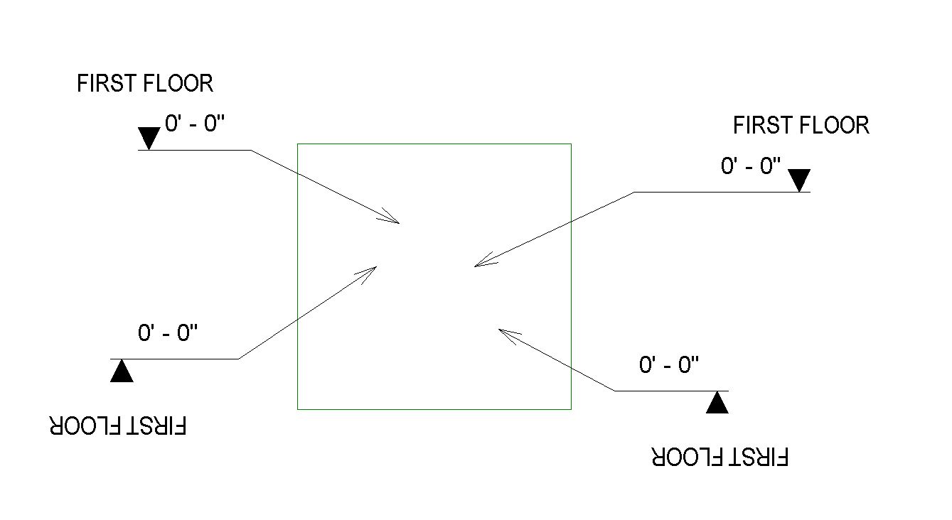

I know that it is an older post but I am currently trying to figure this out.  In the family you uploaded did you notice that in only works correctly if you place it up/right, up/left but as soon as you try to rotate it to read from the bottom the text flips upside down?  Have you fixed this or know how?
