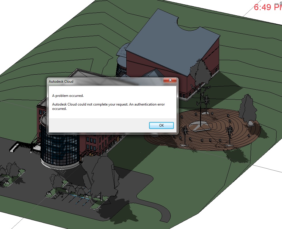

 I am using Revit 2012 with the service pack 2 to loaded. I downloaded the autodesk software for online rendering in revit 360 and it is in my revit tab. I select it to do my rendering. Seems to be going well and I get the message "authentication error" (see attached jpeg)
 Has anybody else had this happen to them?

 FYI,
 I found out that you have to make doublely sure that your user I.D. and your serial number of your subscription match up perfectly. I noticed that our office had 3 different serial numbers for certain software subscriptions. Wrong one was being used for the Revit cloud.
