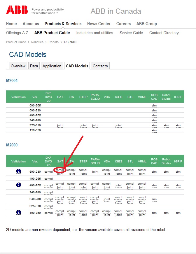

Hey guys, thought I'd share this. I found a supplier of industrial robots that provides 3d models of some of their products.
http://www.abb.ca/product/us/9AAC100735.aspx?country=CA

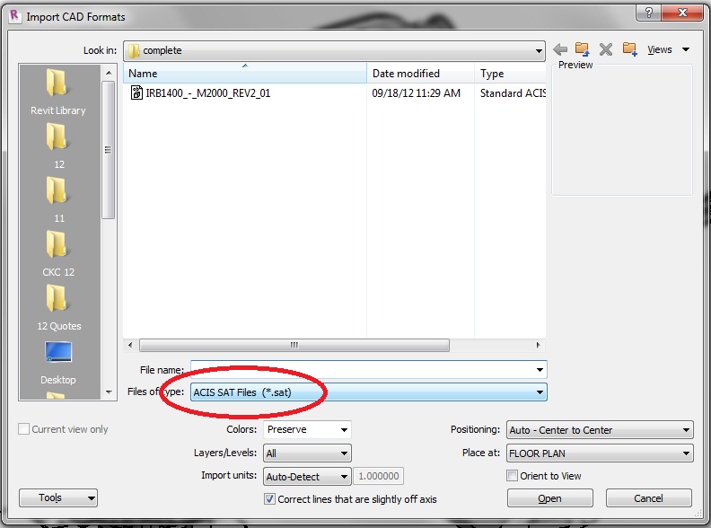

Pick a robot, the go to CAD Models. I was able to get SAT files into Revit but only ones tagged "compl". In revit, go to import CAD and change the source to look for SAT files, find your file and bring it in. I received an error saying the some data was lost but the model still came in.
This may be handy for anyone designing industrial applications.
