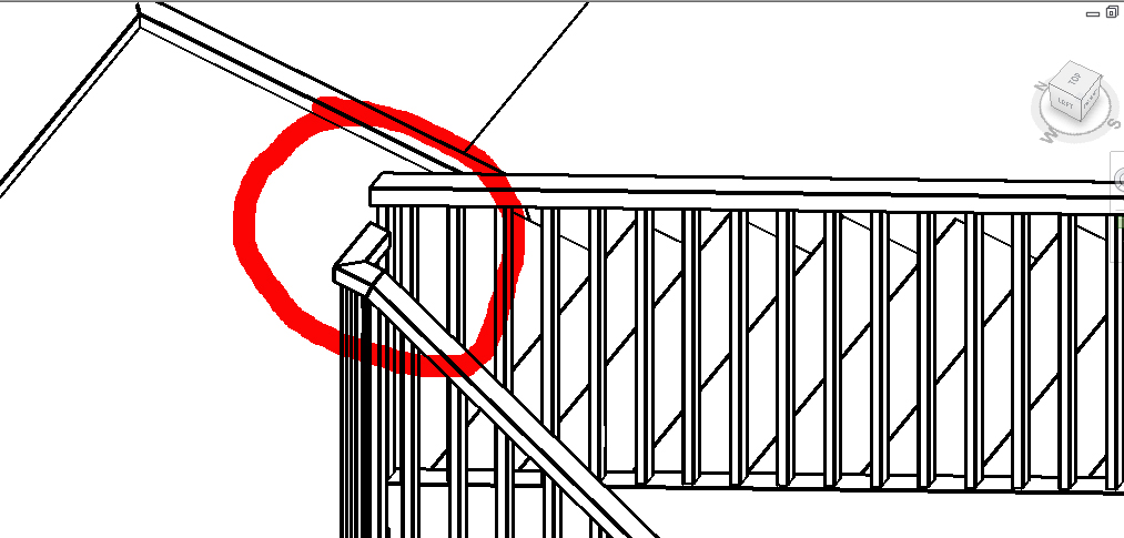

When i sketched a stair, the rail wasn't join at the corner (in the picture)
Sun, Sep 16, 2012 at 8:39:17 AM | Railing problem
Do the railing in one sketch

It's in one sketch already, and i find out that it seems many videos on youtube have this problem too , but still thank you.

Edit that railing and use the "Edit Rail Joins" tool....see the images

Thank you!
