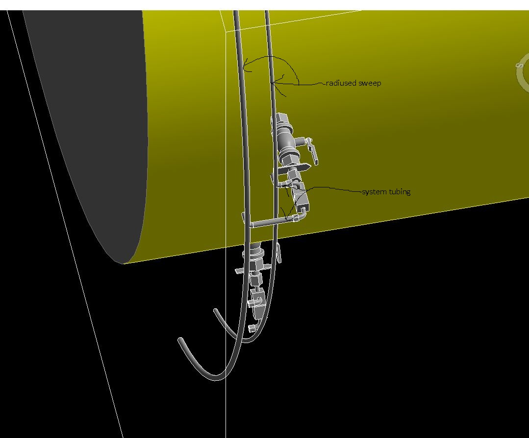

Hey Everyone,
I am trying to show 3/8 tubing wrapped around a 8-0 dia. duct for I&C design but I do not see there is a feature for that capability.
My short fix is to create a sweep profile but not able to create connections perpendicular to the tubing.
All suggestions are welcomed.
Screen shot provided.

You probably have to create a special pipe fitting for this that is a loop.  You could add a parameter to make the loop to a certain diameter.  Then add your pipe connectors into the fitting.

Could be a job for Adaptive Components? I've been looking for something that I could try them out on. Most things in MEP don't lend themselves well to adaptive components but this might do nicely.
