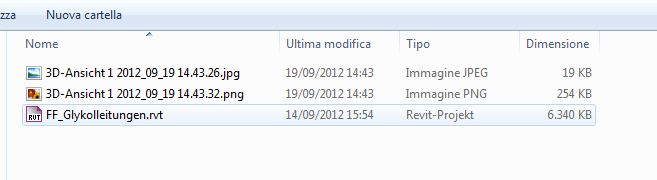

- After render I always save the view twice in the project folder (not in the project browser) you know what I mean?, one in JPG and the other in PNG, is this possible?

after a quick check it should be possible to save files into the root folder of the project...
problem is the name. what if a file already exists? one solution would be to call the file "VIEWNAME DATE TIME .jpg"
would that be ok for you?

hey its almost finished and working.. Smile but i need your screenshot to be able to finish it completely!

its finally working as expected.. Smile
now i have to implement the english version and make some adjustments to the user interface and post it. Smile
