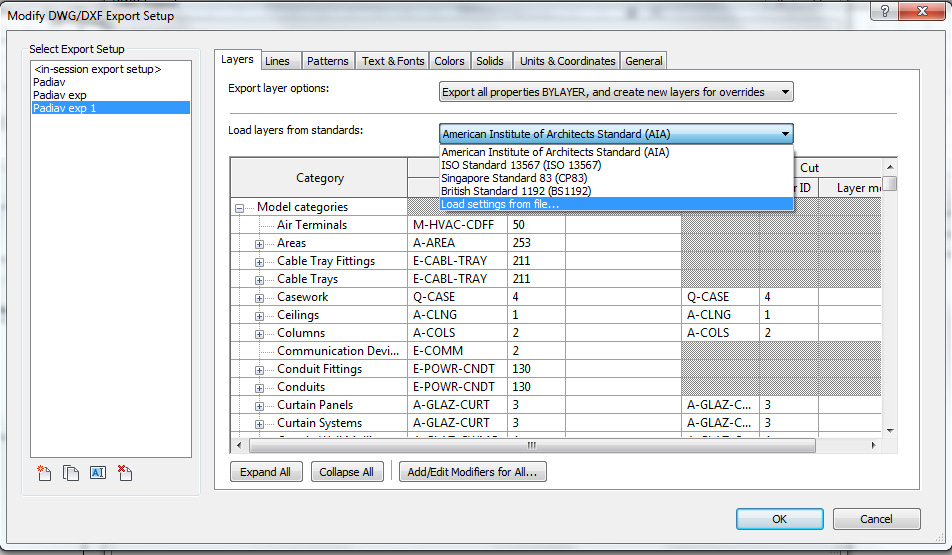

I want to create a custom export layers.txt that reflects our companies standard for CAD layers. I've tried modifying the AIA Standard.txt file but what is in REVIT doesn't reflect what I put in the text file. Is it possible to change model categories? Naming? Or add to a category. The instructions at the top of the file say
Category <tab> Subcategory <tab> Layer name <tab> color number <tab>
Is it really that easy? It doesn't seem to be. What am I missing?

i have same problem with export, how can export this setup to txt?
