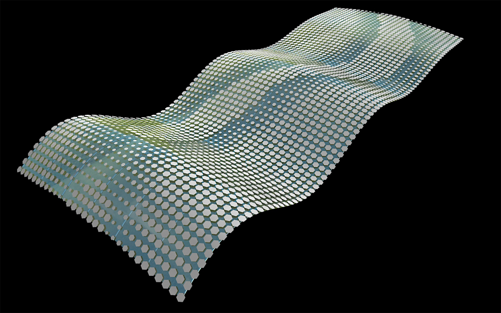

i'm in the process of making a Wave shaped roof canopy family. i'm using conceptual Mass fam. template, by drawing the wave shape in South elevation i got it extruded, now my problem is the wave canopy is supported by "X" shaped bracings (20cm x 20cm steel) (see picture) now i need a tip to create the bracings, which are in diagonal & in wave shape, kind off follow the wave curve and yet in diagonal. Any tips to create this shape.
Note: pic's for example only, canopy shape pic (long span facing you)
thx. W

thx. for the reply. i guess you did not get my point. those brasings are in the wave shape but in other direction of the wave. and they are not bracings but holding the wave.
those pics i attached are examples only,
W

Hi, May be my English is not so good to explain the situation. pls. find attached the Family i've created and the Image that i am trying achive.
can you see the X-shaped steel that is underside of the canopy (holding it.)
W

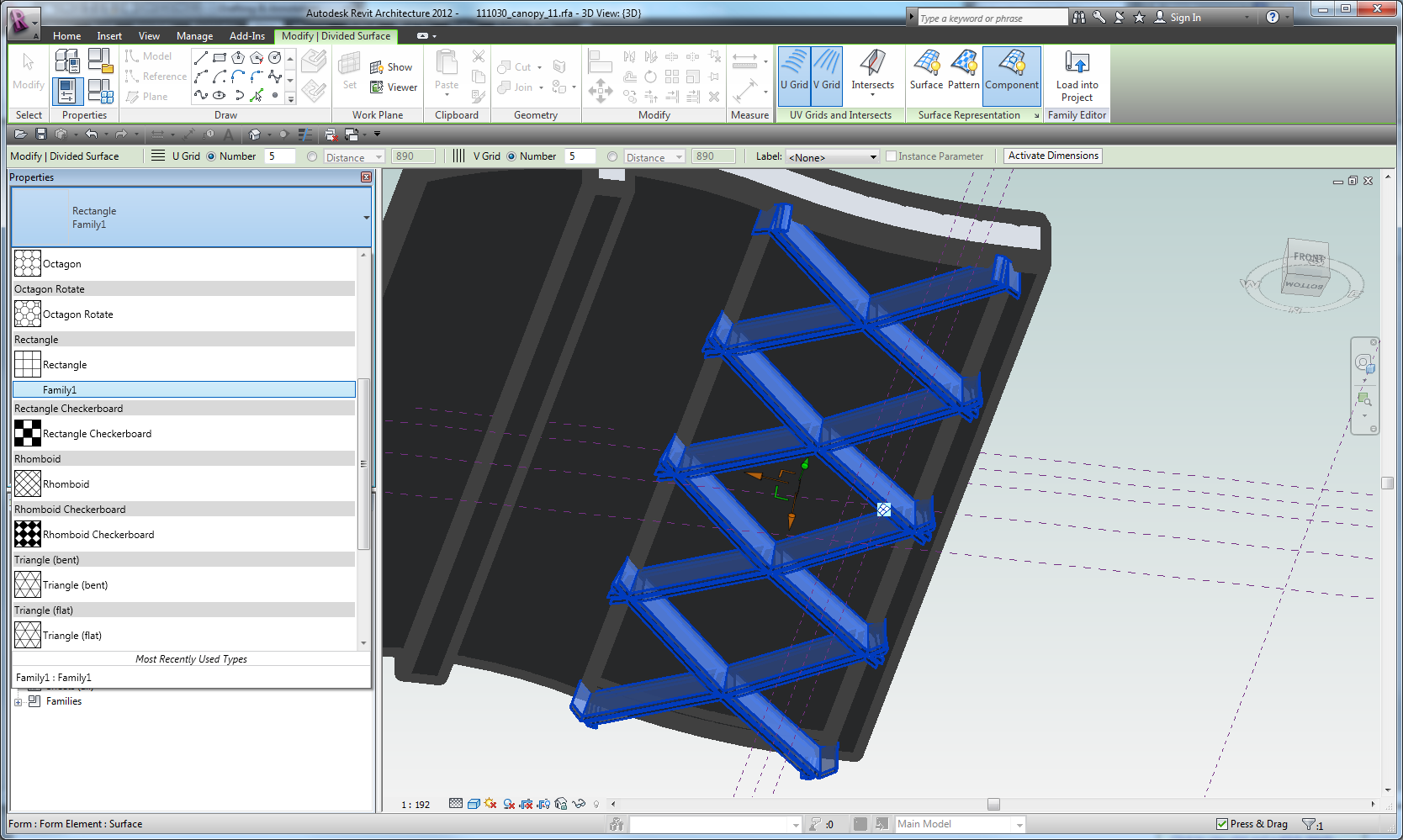

use a pattern based family and create your beam system from it then in your mass model apply the criss cross surface pattern to your bottom of roof andthen apply the paatern you created to it.  See atached image.

very good idea, thx a lot. will try it out for sure.

hi All, here it is. once again thanks for the tip.
