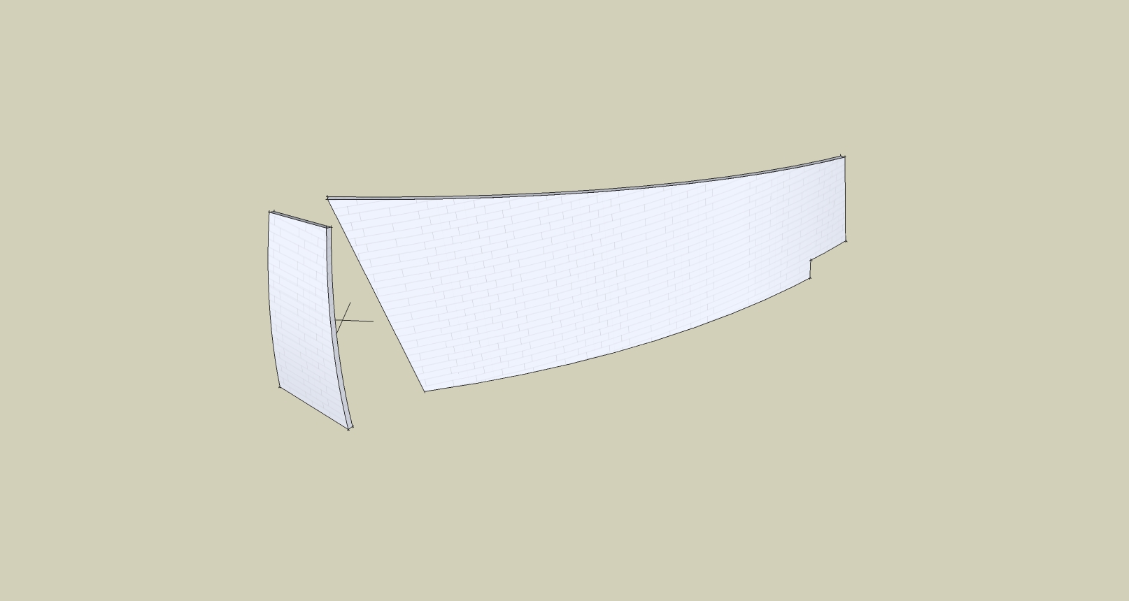

I've been given the job of recreating some curved walls in Revit that were origianlly modeled in sketchup.  The modeler did not keep the original curved surfaces and the geometry is not easily described.  I've tried importing the sketchup model into a mass in revit but I cannot snap to the geometry to place points.  I've tried the same thing in a conceptual mass but to no avail.  This needs to be done in Revit only, no Rhino, etc.
How can I EASILY use the sketchup mass to create new surfaces to apply walls to?  Please be as specific with your recommendations as possible (use conceptual mass environment, use in-place mass, splines, points, reference places, etc) as I am new to 3d modeling in revit.
Using revit 2013.

"Massing and Site" OR "Conceptual Mass" then create a MASS with the correct shape, maybe you'll need to create some VOIDS too, then apply "Wall By Face".

First go to insert then link cad then pick sketchup file type.  Load into project and place where you need it.  Then make an in-place "mass" model.  In your in place mass model use select 3d edges to create the shape of a mass, select the inside edges of your curved wall so you can create a form from.  Once you have made the mass finish it and then under massing and site create wall by face.  That is the fastest way I know.
