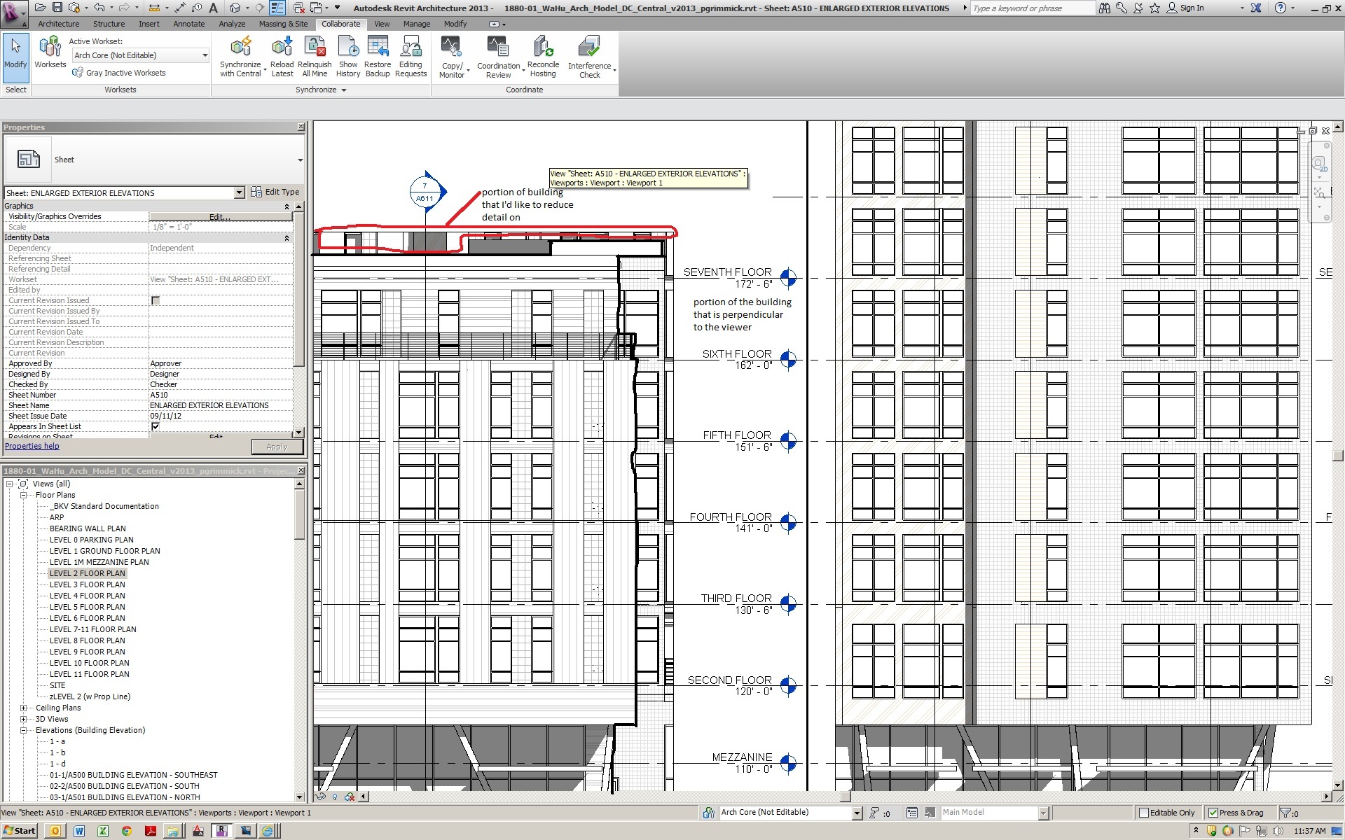

I am creating some sheet for a CD set and have some elevation details that I am working on. I have some overall building elevations (with a course level of detail) that have callouts for portions of the building that are perpindicular to the view so as to create more detailed elevations. In the background are portions of building elevations that are oblique and that I would like to have either blocked out or reduced in detail so that the elevation of the building that is perpendicular to the viewer stands out. Is there a way to do this without having to create a separate elevation from the callout?
Tue, Sep 11, 2012 at 11:05:39 AM | elevation detail for background information
You can select entities that are further back - right click and screen them.
