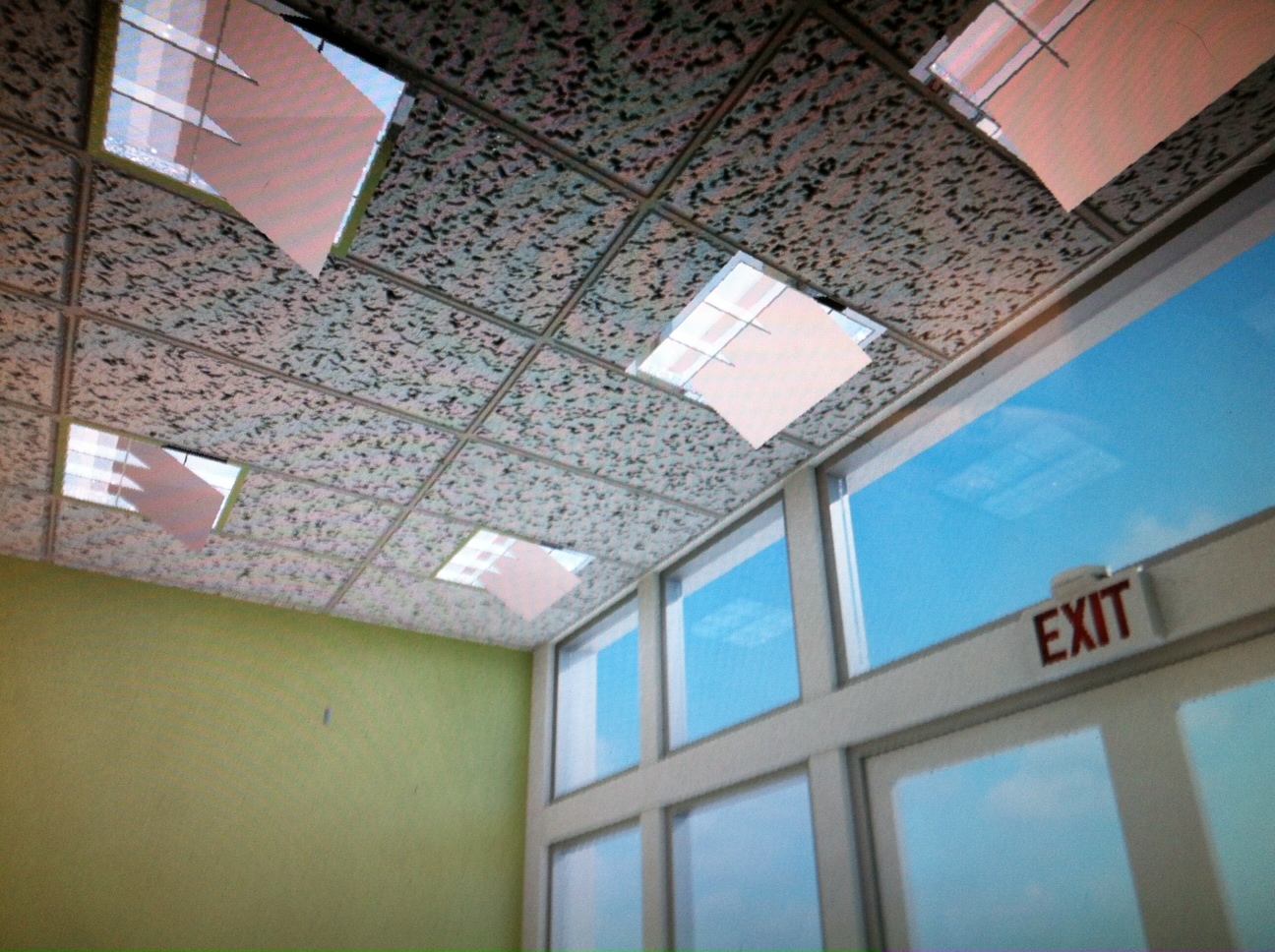

I'm having trouble with a light.
I associated an IES file with an OOTB Revit 2x2 parabolic light.
In plan, elevation and perspective it seems fine in hidden line, shaded and realistic views.
But then when I render it something funky appears.
When I open the family it looks fine though....
Using Revit 2012 and Cloud Rendering / Project Neon
Thanks

(ooh, send those fixtures back for a refund!) but seriously, it could possibly be that your light source's tilt angle may be set to the default value of 60 degrees (why 60, I don't know). Try setting the tilt angle to -90 and see if that fixes it.
