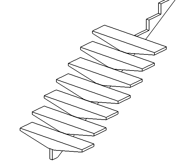

I am trying to document an existing stair from 1974. It has precast concrete treads with open risers, each tread tapers
on its underside from the sides of the stairs to the middle where there is a central stringer below, so the treads look
like wide upside-down triangles in elevation. I have been unable to create a tread shape other than a rectangle. Is
there a way to create a custom tread shape within the stair tool? If not, any ideas on how to create this stair? I am
using Revit 2012.

I have only been able to get a nosing profile to change the shape of the tread in one direction: back to front (if you cut
a section right up the center of a run of stairs, the shape of the tread will change in section if I create a new nosing
profile). But I want to change the shape of the treads as you look at the stair from the front: side to side. So as you
view the stair as you approach it head on you would see the treads tapering from the left and right edges to the center
(see attached sketch).
Can the nosing profile change this?

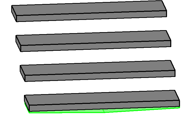

I don't think your going to be able to do this very easily.  You might try to create it as part of the railing system, I'm not 100% sure on how it would all work out but this is something quick I threw together.  Highlighted in green is a railing profile
Edited on: Fri, Sep 7, 2012 at 10:23:28 AM

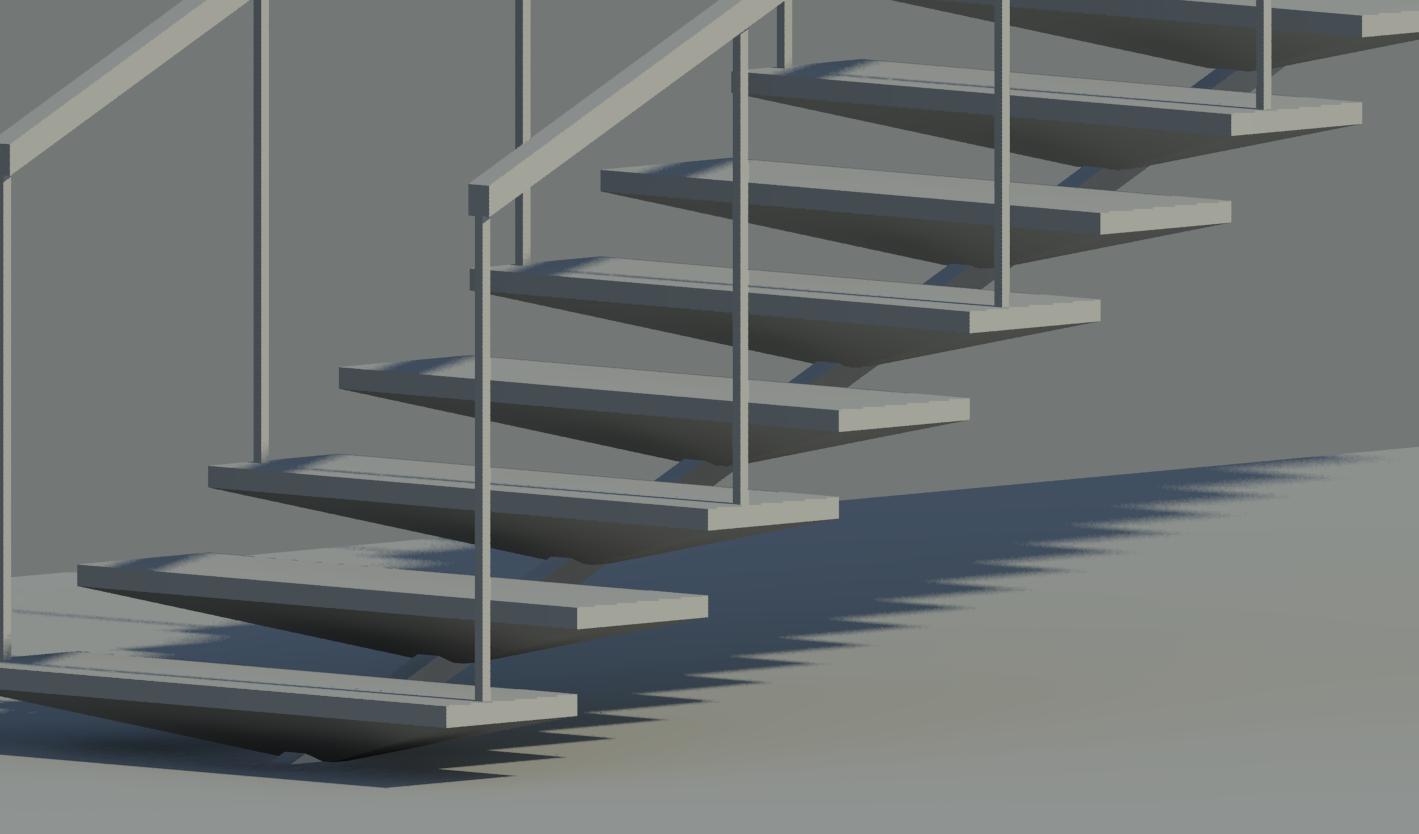

It looks like in 13 you can build the stair and turn off the treads then just add your tread family in the tread locations.  Watch this vid http://designreform.net/learning/2012/05/14/revit-2013-component-based-stairs

2013 has come a long way with stairs since 2012 and I'm a lot happier with it!  I think you are stuck with using the rail and balluster option for 2012 though.  Typhoon thats gallary photo a nice post, I got something similar to that out of the Mastering Revit 2012 book, that book has been a great reference.

Just did this using 2013, component stairs - no treads - no risers and a tread family placed from elevation view.
Edited on: Fri, Sep 7, 2012 at 2:08:54 PM

Just figured it out. Thought I'd post it. I took your advice and used the new stair tool-no treads, no risers and inserted
a tread family.
Mon, Sep 10, 2012 at 8:20:29 AM | Tapered Stair Treads
#13
Good - looks like it works fine.
